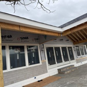

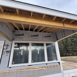

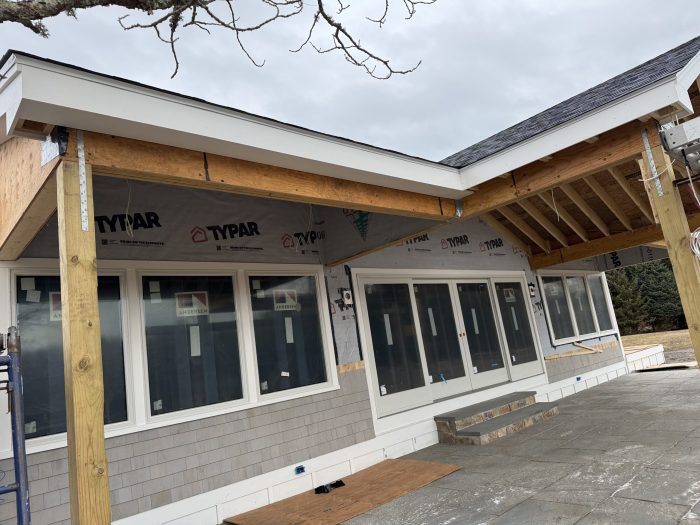

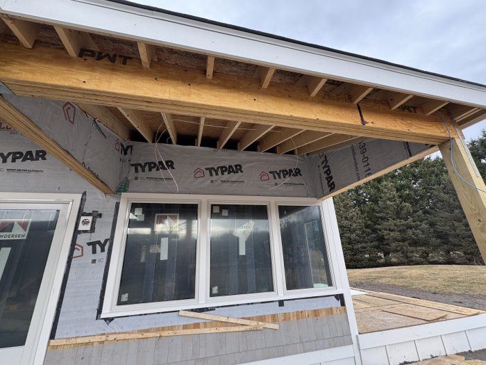

Help! Remodeling a home.  The inside is gutted to the studs.  We are adding a porch roof which overlaps the main roof several feet up.  My contractor was not putting in soffit vents.  I insisted so he wants me to tell him how and where to install them.  The main roof ends over the windows and slider to the porch.  The porch roof connects to the main roof several feet above.  Do we build a box over the windows and doors or can we vent the roof through the porch soffits?  If we did the latter, air would enter the house rafters several feet above the main roof soffits.  Or can we install vents on a vertical surface?

  3. LostHomeowner | | #3
    It’s an open porch. See photos. And thank you for your help.

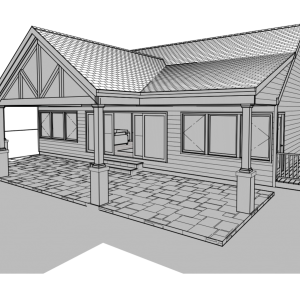

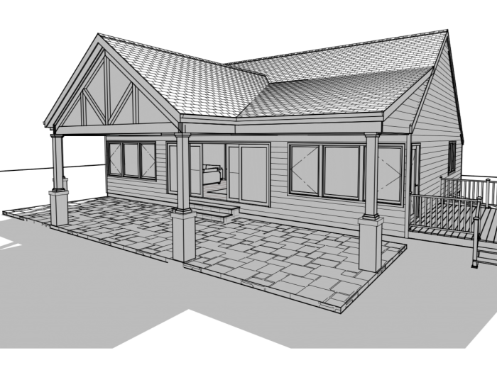

    1. LostHomeowner | | #4
      Also see drawing attached ( close but not exact).
