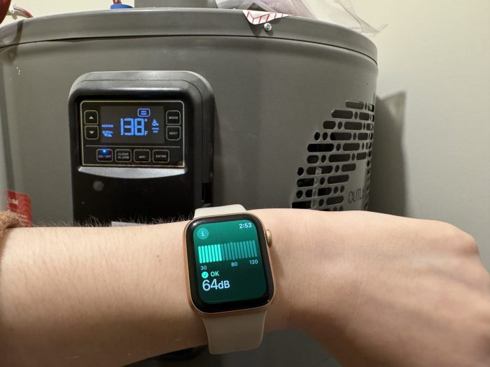

I just discovered that the previously listed noise ratings for the Rheem hybrid heat pump water heaters (Prestige Proterra) were incorrect and have since been changed. All models were rated at 49 dba but upon calling Rheem to inquire about our very loud equipment, they informed me it is actually expected to be around 60 dba once installed in a home. Had I known this I would have ensured we seriously soundproofed the area. As far as I know, 60 dba is about 4 times louder than 49 dba in terms of noise perception, but actually 12.59 times higher in terms of sound intensity. That is a pretty big difference and I am sensitive to sound to begin with.

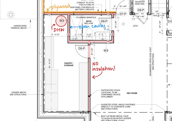

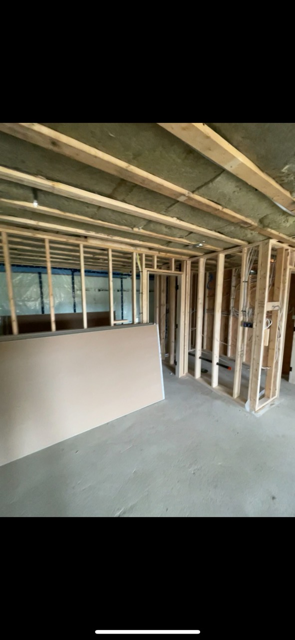

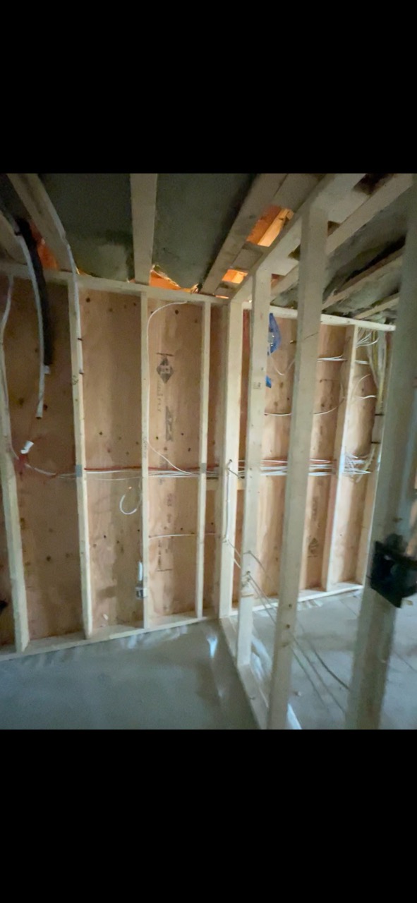

See drawing below and pics showing the space pre-drywall. The mech room north of the water tank has plywood on the walls, unfortunately there is no insulation in the wall separating from the water tank but I suppose we could remove the plywood and try to add some. On the other side the tank is right against an unfinished bathroom, also no insulation on this wall but it’s just an open cavity right now so we could easily add something here to soundproof it if that would help. The big problem I see is that we have no insulation in the wall separating the pantry room (loud with the tank in it!) from the living space and it’s already drywalled/painted now.
Just curious how you would approach trying to block the noise from the water heater in the main area. We will keep the mechanical room door closed so it doesn’t matter if it’s loud in there. The pantry room door can also stay shut but there is a large gap below. The bathroom door will stay shut for now while unfinished, but it would be nice to someday be able to use that bathroom without an extremely loud mechanical noise.

        Unfortunately the walls/ceiling is already mostly closed so as I mentioned the only spot we can easily add insulation is in that bathroom/shower wall which is still open since the bathroom is unfinished.

    @schmoot - Well we want the cold air in this room, that was the point of putting it in there. So we don’t want to send the cold air elsewhere… unless we close off the little area where the tank is and vent into the main pantry room. It is shown on the drawing I attached.
