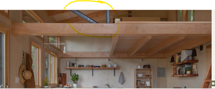

      Loft constructed as shown here. We are increasing cabin size slightly. We want to attach a staircase to the loft beam.
      https://www.elevatedspaces.ca/products/redwood-cabin-plans

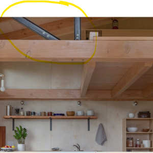

      1. krackadile | | #10
        Looks like there are a couple of metal tube steel hangers that are also supporting the loft from the roof framing.
        1. LearningtoBuild2025 | | #13
          Yes the metal is not necessary.
          This guy said he did it just for extra insurance and because it looked cool.
          We’re not using the metal brace.
  2. krackadile | | #2
    So, the notch would be in the top of the 8x8 and would be 3.75"Dx3.5"Wx7.25L? Yeah, notching a beam on top or bottom like that significantly reduces the capacity of the beam. I don't think that would be a good idea if you want to span 16' and use this as a beam to support your joists. You'd be reducing the beam by about half it's original depth so it would act more like(5) 2x4s sandwiched together than an 8x8.
    What about structural screws? You could place your 4x8 and 8x8 at the same level perpendicular to each other, drill some holes about halfway though the 8x8 in order to countersink the screws and then run the screws into your 4x8s. Depending on the size of the screws would determine now many you need so you'd have to figure that out. Then you could use wooden dowls to fill the holes and give you the timber frame look avoiding the joist hangers? Or, you could just use wood dowels for that matter but you'd need to read about how many you need to support the structure.

      Thank you. The 4x8s as in the plan are designed to be cut somewhat at an angle to fit into the notch reducing the 8” portion by half where the rafter sits into the beam’s notch.
      The plan as is, according to the designer who himself also built this design…is designed to irc code, including CA code. But does not account for a staircase.
