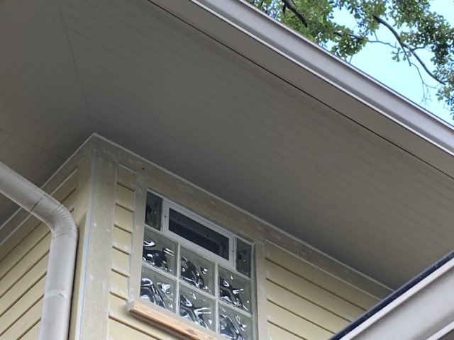

I am in zone 2.  I am working on repairing a storm-damaged house that was built in about 1914 and is not air sealed. It was added onto in 2000 and no sheathing was used by the person that built the addition.  We have been adding plywood sheathing plus new insulation, siding and drain wrap (and replacing any damaged dry wall) to the walls that don’t have any exterior sheathing.  We got to a wall section with a shower on the inside and discovered mold visible from the outside on the shower substrate (some sort of tile backer board or just plain drywall).  We now need to redo the shower.

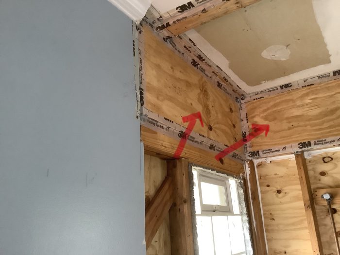

I read the following thread: https://www.greenbuildingadvisor.com/question/is-the-shower-wall-a-vapor-barrier . The responders say that the shower surround is a vapor barrier and mention being meticulous with air sealing.  We have been doing our best to seal the exterior plywood we have added to the 2000 addition, but the top of the bathroom wall appears to open into the soffit and the floor (the shower is on the 2nd floor) opens to other areas of the house that aren’t air sealed at all. We will do our best to seal the bathroom wall from the soffit on the inside.  I can’t redo everything though nor do I have access to redo everything.  The shower has 2 walls that are located on exterior walls of the house.  It also goes all the way to the ceiling and the ceiling has tile.  From reading the thread, it sounds like it will be a vapor barrier once installed correctly which we aren’t supposed to have in our zone.
It sounds like my best bet might be to air seal the area where the shower is now and not go all the way up to the ceiling with the new shower so that it isn’t a complete vapor barrier on the section of wall that makes up the shower.  My husband would prefer that the shower go all up the way up to the ceiling.

    The vapour drive in hot / humid climates is to the interior, so you want your walls to be fairly vapour-closed on the outside, and vapour-open on the inside to allow them to dry. The problem at the shower is you end up with a cold side vapour-barrier. The warm/moist outside air makes its way though the wall until it hits the colder impermeable shower and condenses causing moisture damage. The complete reverse of the usual situation in the heating dominated climates most of us are familiar with.
    I would suggest a layer of either foam-board or closed cell spray-foam against the backside of the shower walls to keep it warm enough to prevent this.

      We have a vapor open wall assembly on the walls of the house we have been repairing:
      Fiber cement plank siding | TamlynWrap Drainable Wrap | 15/32 3-ply CDX plywood | Rockwool Comfortbatt R15 insulation | Georgia Pacific - Toughrock Fiberguard X Mold-Guard Gypsum Board
      We are trying to finish the outside house repairs before we get to much further into hurricane season. We sprayed the mold and closed the shower wall sections and will work on the shower when we finish the outside (hopefully this week). The shower wall sections have:
      Fiber cement plank siding | TamlynWrap Drainable Wrap | 15/32 3-ply CDX plywood | tile substrate (looks like green rock) | tile
      How would the foam-board or closed cell spray-foam work with the wall assembly we have been using in the repair or would we do something different on the shower walls?
      I thought if we used Schluter, we would add the rockwool after the plywood and replace the tile substrate with Kerdi-board or drywall/Kerdi membrane then tile. Regardless of what we use we have to make sure the shower sections of the wall are air sealed as tightly as we can make them. Please bear with my ignorance on the subject.
        MALCOLM TAYLOR | | #7
        elenan3,
        The foam board or spray foam in each stud bay against the backside of the shower will keep the moist air that has come from the outside from condensing, or mold from growing. Your wall assembly would remain the same as elsewhere with the exception of that 1" of foam, which should be taped and sealed at the perimeter.
