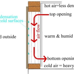

  24. homedesign | | #24
    Charlie said:
    "It really seems that our problems are primarily in the winter nighttime when the hot trapped air in our partially vented rafter bays.... "
    If Charlie is correct ....
    Wouldn't the "problem" be warm moist interior air ... finding it's way to cold surfaces?
  25. user-1149079 | | #25
    John,
    That's correct. We want to remove the cold surfaces or at least prevent the surfaces from getting cold. Or we could try to exclude this warm moist air from getting to the cold surfaces, or both. But I think we have a better chance at successfully achieving the former using the exterior insulation and the fact that barriers are rarely leak free.
  26. user-757117 | | #26
    David and Charlie,
    I agree that there is probably no energy performance benefit to having an air barrier in this case.
    But I'm not-so-sure it isn't still a good idea from a durability point of view...
    I think John's comment (#24) is salient.
    Without an air barrier I imagine there could still be a condensation issue within the "3D network" - see the qucik and dirty drawing that I attached (the gaps are exaggerated for clarity).
    Condensation in this case would be trapped between the rigid foam and the top of the roof deck.
    A drywall ceiling could possibly be detailed to act as an air barrier, with T&G applied afterwards - but if drywall is to go back up why not just finish the drywall without T&G?
    Maybe a sprayable caulk inside the rafter bays could be used instead of drywall as an air barrier?
    Then the T&G could be applied without bothering with drywall...

  45. homedesign | | #45
    Charlie,
    I visualize the air in the rafter cavity to flow more like the air in this wall Illustration.
    I adapted this sketch from an illustration in John Straube's textbook.
    only there would be more condensation near the top
