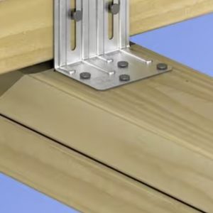

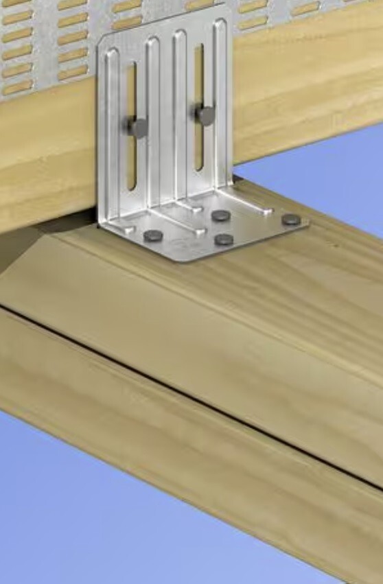

Hey, I am a construction manager and owner’s rep in the ski town of Steamboat Springs, CO. I am working on a house with long trusses that span over some non-load-bearing interior walls. There is already about a 1-2″ – 3/4″ gap between the bottom truss chord and the top plates of the wall. I know this builder isn’t necessarily going above and beyond on attic insulation and air tightness, so I am anticipating that there is a chance of truss uplift. The builder has in the past shimmed the gap between the bottom chord and the top plates and has even gone so far as to screw at an angle a truss screw from the top plate into the bottom chord to suck it tight and prevent the uplift.
I know that the screwing might not be best practice, but is it really that bad? What about the shimming?
  1. Malcolm_Taylor | | #1
    Reese,
    If the trusses aren't free to move by being fastened to intermediate walls one of two things can happen: The trusses will lift those walls, or the truss chords will distort and can cause them to fail. The truss drawings typically include specifications requiring truss clips to be used. Clips, and keeping fasteners 16" away from the ceiling / wall intersection are the standard way this is dealt with.

    Malcolm, If you are using something like SIGA Majrex as a ceiling air barrier, all those truss clips are going to be penetrating that air barrier with 2+/- inch wide slits. Bigger problem - you can't nail into the top of the wall with that vapor barrier across the top of the walls. Is there an alternative way to install these? I am thinking of inverting the clips so that the slotted connection is nailed to the wall top plates. But the truss clips are fairly thick, so likely would have to notch the top plates.
    Another thought would be to predrill holes in the wall top plate at the truss connections. The drilled holes would be slightly bigger than a nail, and then hand-nail leaving the nails proud of the top plate. Basically the same concept as floating basement walls to account for any slab heave. If the air barrier is sealed with acoustical sealant at each truss around where interior walls attach, then air leakage at the nail holes would be minimal. Thoughts on this?

    1. Malcolm_Taylor | | #6
      Tracy,
      The severity of the problem definitely varies depending on climate, length of the truss, and how the attic is insulated.
      The common practice here is to frame all the interior walls before adding the ceiling air / vapour barrier. When those walls are framed we run strips of poly between the two top-plates, which get lapped and sealed with the poly on the ceilings, so there is no conflict with the clips.
      But I'm not understanding the problem you are describing with a continuous membrane on the underside of the trusses. The sequence would be:
      - Stand and brace the trusses.
      - Run the ceiling membrane.
      - build the interior walls
      - Nail or screw the truss clips to the top face of upper top-plate on the walls through the membrane.
      - fasten to the side of the bottom chord of the truss through the slot.
      To Micheal's point: I should have been clearer. Although truss clips are called out, their use still isn't that common. Lots of builders here just nail the hell out of them to try and stop the movement, and many production builders tack the walls to the trusses using just enough nails to keep them in place until the walls are boarded - relying on drywall to keep the walls where they should be.
