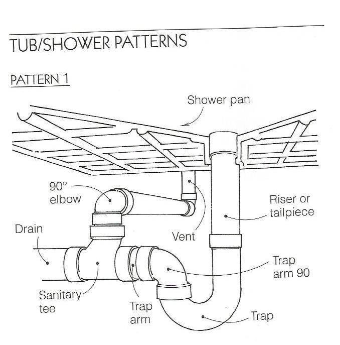

    I need to go in my crawl space to look but I wonder if it’s something like this? If the trap is below my floor would I even need a trap directly at the sink?
    All the sinks could be connected to vent in this way in the crawl space
      DCcontrarian | | #38
      The trap can be up to 24" below the drain. That's measured from the rim of the drain in the sink to the water level in the trap. The trap could be below the floor like that but it would have to be a deep and low sink.
      1. derekr | | #39
        If it’s connected to the vent this way then I still need the aav then
          DCcontrarian | | #40
          You know, I don't know. The piece between the sink and the trap is called a tailpiece, I don't know what the remedy is for a tailpiece that's too long. It's not going to be adding an AAV, which needs to be on the downstream side of the trap.
          Probably the remedy is moving the trap up and adding an AAV. Or, if the vent goes through the wall behind the sink, tying into the vent in the wall.
            DCcontrarian | | #41
            The reason for the height restriction on the tailpiece is that if water leaving the sink gets going too fast it can sweep the water out of the trap. An AAV isn't going to help with that because it's not caused by a vacuum in the pipe.
