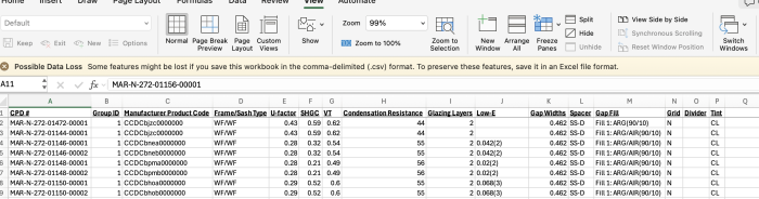

Hi there, poking around on the NFRC site to x-shop windows (JW Siteline Clad vs Marvin Integrity FG/FG vs Integrity FG/Wood)
http://www.nfrc.org/certified-product-directory/
Can someone explain the Low-E information on the site? For a particular configuration it says “0.022(2) 0.149(4)”. This one the configuration I’m looking at, on the Siteline it yields U0.24 and SHGC0.18, similar code on Marvin yields about the same, U0.25.
I don’t know how to translate this into an “orderable” configuration though, and when I click the pop-up on the NFRC site nothing happens. I’m guessing the parenthetical numbers refer to number of surfaces, so 4 might mean a room-side coating?
The document “NFRC_CPC_Code_Listing” does not explain.

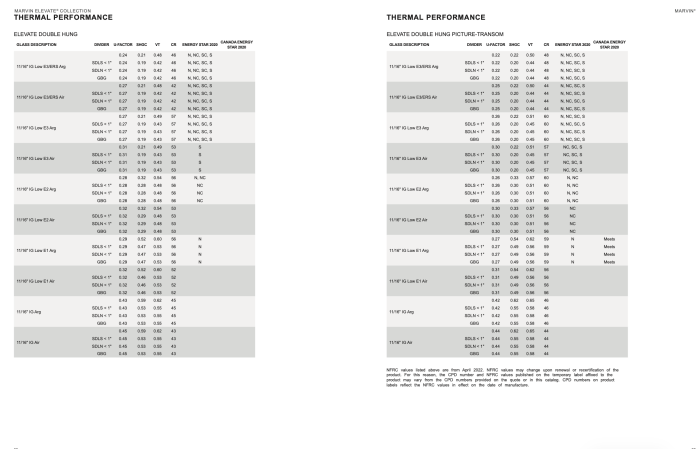

Also, related, when I go into the Marvin site, below, I don’t see casements under Integrity, not sure why or maybe my browser doesn’t show.
https://www.marvin.com/support/energy-data
thanks!

          The doc actually decodes the last piece of the puzzle, the chart on Page 3 lists LowE coatings and their emissivity. 0.022 is their LowE3-366 coating. 0.149 is their LowE-i89 product (which is indeed the indoor lite coating).
          So the Marvin window I was looking at has that combination.
          Looks like all the 0.25 to 0.27 U factor options have that combination. At 0.28 they have the 0.022 366 coating on one inside surface only. Not a huge tradeoff (drops from R4 to R3.6), and condensation resistance jumps from mid 40s% to 59%.
          http://search.nfrc.org/search/cpd/cpd_search_detail.aspx?cpdnum=MAR-N-375
          The Jeld Wen listings are much easier to understand now that I figured it out, the product code provides all the clues. They seem to offer a lot more of the coating permutations than Marvin.
          http://search.nfrc.org/search/cpd/cpd_search_detail.aspx?cpdnum=JEL-N-877
