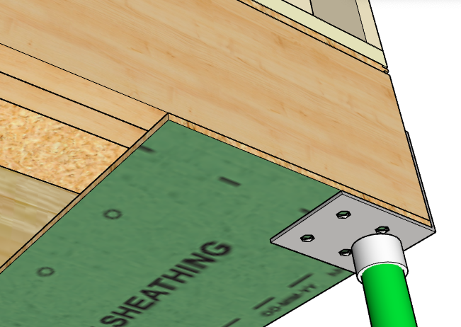

I’m in zone 6 and the floor assembly is on piers, 6″ off grade. Underneath is 6 mil poly and 4″ of trap rock.
From the bottom up:
ZIP sheathing
1 1/2″ rigid (EPS or XPS?)
Rigid edges air sealed
10″ Unfaced fluffy
Advantech X-Factor subflooring
I’m nearly ready to order my floor assembly materials but am confused regarding EPS, XPS and vapor.
It seems to me that I’d want the assembly to dry to the inside and therefore unfaced fluffy.
But, which rigid? I’m assuming XPS given its lower perm rating than EPS.
And/or, do I add a smart vapor retarder layer somewhere in the assembly?

  4. Tiziano | | #4
    Thanks Malcolm.
    We're building it in 2 halves, upside down. Each half is 8' x 12', rimmed with 1 3/4" x 11 1/4" LVLs. The outer 12' side of each half is 2-ply.
    After installing joists and blocking we'll add the ZIP (or a better sheathing) and tape. Then we'll flip the halves and put them on the pier L-brackets.
    Then we'll add 16' LVLs spanning both halves, and connect the central abutted common ones to each other. Finally we'll tape the outer edges.
    The result is 12' x 16', 2-ply LVL rims all around the perimeter, and a 2-ply center.
    Then it's just a matter of adding rigid to the bays, air sealing the intersections, adding batt, and covering with X-Factor.
    The brackets are 6x6 galvanized and we'll bolt through them into the LVLs.
    Image is missing the ZIP tape and insulation.
    1. Malcolm_Taylor | | #9
      Tiziano,
      That sounds like a well thought out plan, except for the foam.
      The main advantage of using a layer of foam on the underside is to reduce thermal bridging - and you lose that if the foam is in the joist bays instead. If it goes there, don't think it's even worth including.
      I would skin the whole underside with foam before sheathing it - except for 2"x4" blocks where the piers are so you have solid bearing. You then have a 99% continuous layer which is completely protected by the sheathing, and can still secure it to the saddles the same way.
      No need to air-seal the joist bays, just the intersection between the two halves of the floor, which you can do with a gasket or sealant between the LVLs, or by taping the joint at the sub-foor.
      1. Tiziano | | #10
        What a great idea Malcolm! It gives me CI under the floor like I'll have on the walls.
        Between your suggestions and climbing carpenter's I think I've finally got the floor assembly sorted out. Thanks.
