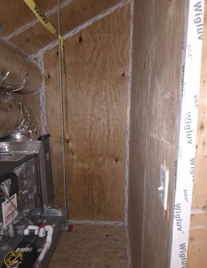

Vapor drive is a subject I still don’t have a full grasp on, so I’m looking for help in determining if this wall assembly in our attic is a possible moisture issue.
Our HVAC closet in the attic (attached to a finished bonus room above living space) will be air conditioned. Our HVAC guy decided to use plywood as the interior walls in that closet.
The rest of the wall assembly will likely be fiberglass batts on the attic side and Tyvek commercial wrap (leftover from the exterior) carefully detailed to be our attic side air barrier. The rest of the bonus room with be drywalled on the interior side.
Being in a mixed/hot humid climate would mean the vapor drive would be predominantly inward, correct?
If so, would that cause an issue with the interior finish of that closet being plywood instead of drywall? The closet size is about 40-50 sq ft.
I know plywood is less vapor permeable than drywall, and we don’t want to cause any potential condensation and mold risks. We came from a moldy home before and it caused severe illness in my family, so we’re doing everything we can to try to avoid those issues.

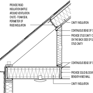

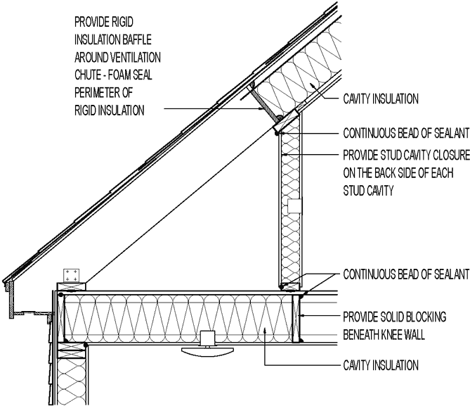

    1. tjones1014 | | #2
      The roof isn't insulated yet. We plan to make sure they follow this diagram with the blocking and baffles. As far as I know, the roof line will also have fiberglass batts, but I don't know what R-value.

        DCcontrarian | | #3
        OK, the roofline is the area of concern. There has to be continuous ventilation between the insulation and the roof from the soffit to the ridge. It looks like that's what's specified, you have to make sure it gets built. Without ventilation moisture will accumulate in there and cause all kinds of problems.

            BILL WICHERS | | #7
            I like to use 1/4" wafer board for the baffles, secured to 1x2 furring strips used as spacers to define the depth of the vent channel. This is cheap and effective, and is quick and easy to build. A finish nailer makes fast work of things here. You can also fet factory made baffles which are usually made from a semirigid plastic material or thin formed rigid foam.

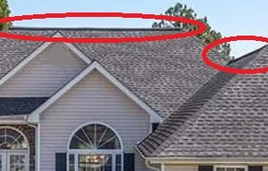

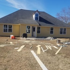

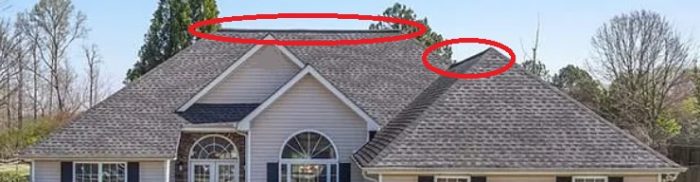

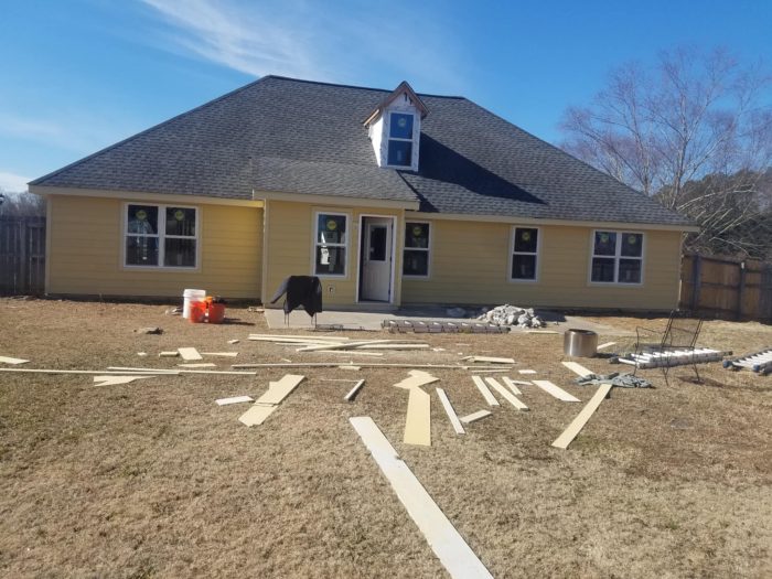

      1. tjones1014 | | #11
        The drawing I posted is from the GBA website. I was using it as an example of how we planned to have them complete the knee walls with the blocking and everything.

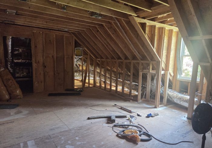

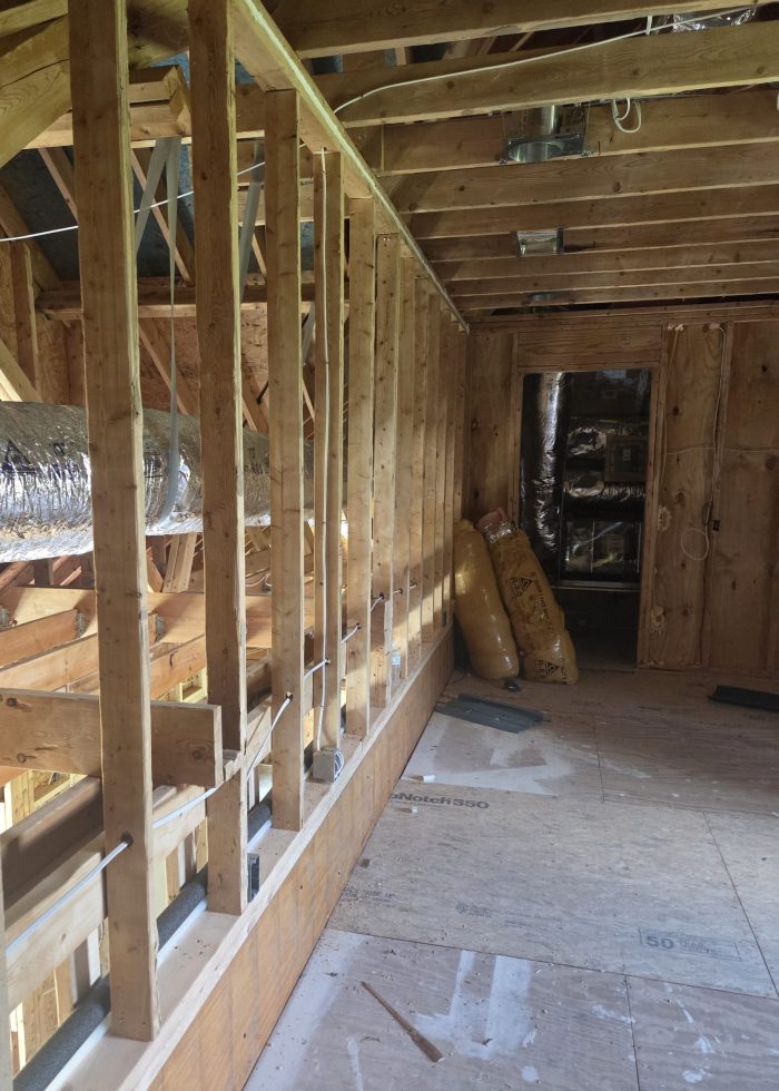

        We don't have any drawings of the roof or floor plan, as this is a reno, but I've attached some pictures I had on my phone before and during construction that hopefully help you get an idea of the roof from the exterior. I circled in the first pic where there is venting. I believe the front gables and the dormer window in the back are also vented at the top. Our soffits are vented all the way around the home as well (except in two 4-foot areas where our bath fans will vent through the soffit to the exterior).
        I can take some pictures of the inside of the bonus room later today.
