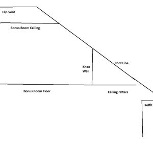

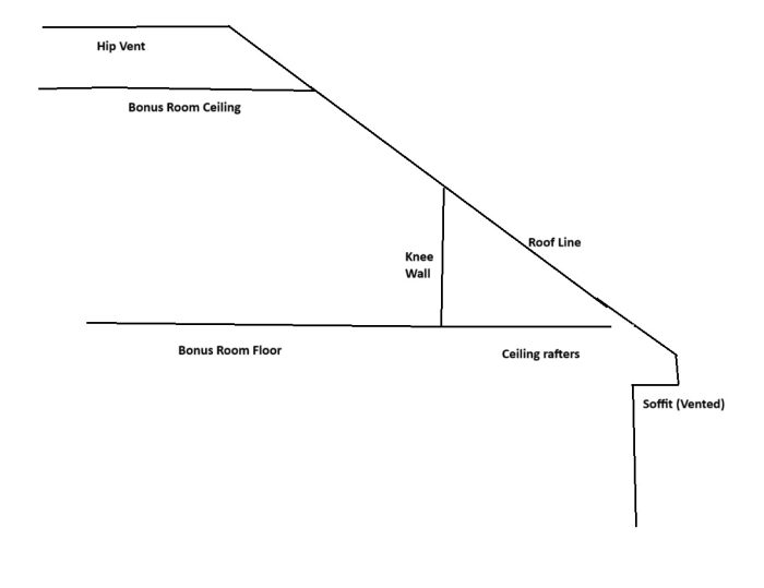

We’re trying to ensure the sloped ceilings at the knee walls in our attic maintain open ventilation channels. We had our insulation company install Provents, but they did an awful job. They’re incredibly squished, and I’m tempted to scrap the whole thing and start over.
1. Does the material selection for ventilation baffles (plastic like we have vs rigid foam vs wafer board) matter that much if we make sure they’re air tight (tape the sides to the roof sheathing, tape between each baffle seam, etc.)? Trying to prevent condensation and mold, so do we need a more vapor permeable option in our climate.
2. If we keep the plastic baffles, is there a way to create braces/blocks in the middle of them to make sure the channels don’t get squished?
3. Do we have to go from soffit up to the hip vent above second floor ceiling insulation? Or can we start at the back of the knee wall and go up above the ceiling? We used rigid foam to block at the knee wall “top plate” (on the attic side).

    A drawing of your roofline would be helpful here.
    I think your best option is to use 1/4" waferboard here. You don't need to seal it like an air barrier, your air barrier should be on the interior under your insulation (I'm assuming you're insulating the roofline here). Waferboard has the advantages of being cheap, rigid, and reasonably vapor open. If you want some extra R value, put a layer of foil faced polyiso under the rafters with seams taped. An interior side vapor barrier with a vented roof like this can be helpful as it will limit how much moisture gets into the assembly from inside. Note that in your more Southern CZ, you won't have as much of a wintertime moisture issue as we in the more northern CZs do.

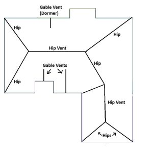

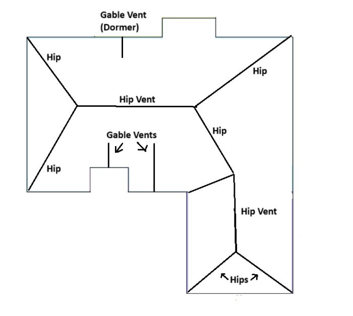

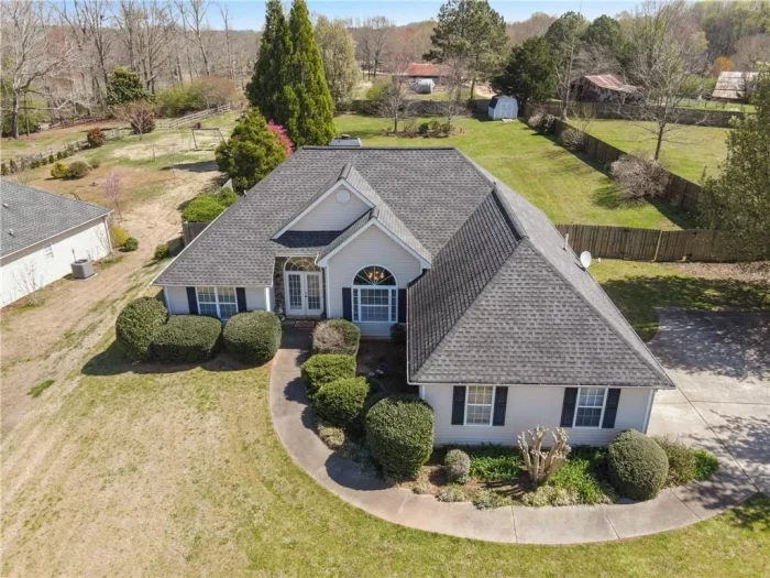

    I included a couple of hand drawings and an image of the house from the exterior. Is that helpful? There aren't knee walls all the way around the house, just certain areas of the bonus room.

    Note that those hipped roofs make ventilation much more difficult. You did mention "hip vents" above - are you installing ridge vents or another material below the hip shingles? Unless you do something there, the ventilation is pretty useless.
