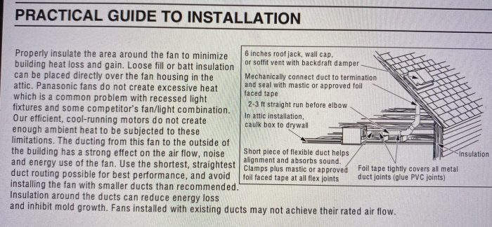

New construction house one floor:  The instructions state we can vent the Panasonic bath fan through the roof, (which is shortest route) but how do we stop the cold air from coming back into the house?  I don’t want a cold bathroom (zone 6) and most dampers have nickel gaps around them and I am tired of listening to the damper bang every time the wind blows here.   We will be in a very windy area.
Last, does well insulating the pipe stop the condensation from forming in the pipe since we can’t slope the pipe?

    You face the same problems with possible air infiltration through the duct whether it terminates on a roof or wall. These are very effective:
    https://www.tamtech.com/product/cape-backdraft-damper/?srsltid=AfmBOooje22mmwPsMF-SRktmI9_XDVA1VQfTQegODrcCFe6s62VCVpcs
    The main benefit of sloping the ducts is to make sure there is no low spot for moisture to accumulate, and although you will not have a drainage path to the duct termination if you go upward, with a vertical duct there will never be a opportunity for more than an incidental amount of condensation to accumulation. And yes, insulation will help reduce condensation.
