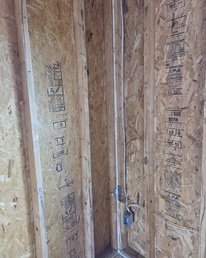

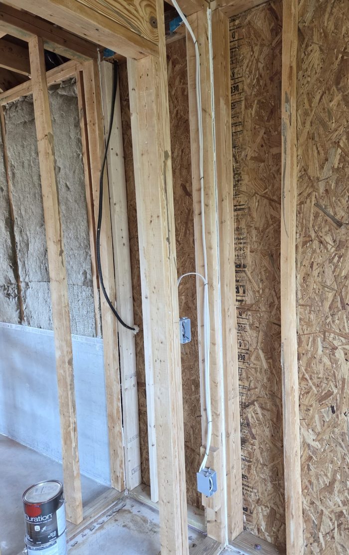

Can someone please help me figure out what to tell my contractor to do for interior wall intersections like the ones in the attached photos? We are doing Rockwool in the stud bays, but I’m at a loss for what to do in these areas.
Would not insulating create a thermal break here and lead to potential issues? Or is it ok to just re-caulk / foam the seams and call it a day (like it was previously done when the home was built)?
Or do we need bother insulating/sealing those corner seams at all?
For extra context, here’s our assembly:
Hardie, Benjamin Obdyke Slicker Max rain screen, Tyvek commercial wrap, OSB w/ taped seams using Siga Wigluv (Fentrim at slab)… Rockwool and drywall to come soon
Our goal was to make the home more air tight, not perfectly air tight.

    Fill the voids with canned spray foam and call it a day. You can even use high expansion foam if you'd like in this case, but regular window and door works as well (you'll just use more of it).
    It's otherwise not the end of the world if you don't get this detail perfect, as you're in a pretty mild climate and have taped the seams on the sheathing outside.

    I'm going to assume here that you want to insulate the interior void between the studs at that T junction? There is no problem insulating in there, and you SHOULD insulate in there to avoid a cold spot. If there is no way to get in there with the batts you're planning to use, then injection foam is probably your best option. Note that you might be able to just pop one of the studs out and then toe nail it back in after insulating.
    1. tjones1014 | | #3

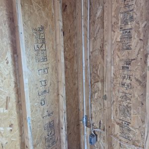

      Correct, that's what I'm referring to. Thank you! A few follow-up questions:
      1. Does injection foam come in closed cell & open cell options? If so, which would you recommend for my climate zone (GA - 3A/4A line)?
      2. What about corner junctions like this pic (attached)? Do you recommend the same method for insulating, or are these treated differently?
      3. If we taped the exterior OSB seams with Siga Wigluv, do we also need to caulk the junction seams like it was done previously (the white caulk in the pictures)?
      Appreciate the help!
        BILL WICHERS | | #4
        1- The two part injection stuff is usually closed cell as far as I know. Your install contractor can tell you for sure. I will sometimes used canned foam in small spaces like this, and that stuff, while it claims to be "closed cell", is really a bit of a mix of both.
        2- Sometimes those corners have an extra stud or two in them, so insulation doesn't always fit. You'd probably need to insulate these from the exterior. Sometimes 1.5" thick rigid foam is handy here, because it can fit into a stud-size space. I would try to insulate ALL areas of the exterior wall as much as possible.
        3- I like to caulk too, although I prefer to put the bead of sealant between the faces of things and not on the edge, but that's not usually an option with renovation work. With air barriers, it's best to have more than one for reedundancy. Tape AND sealant helps to make sure you have a good air barrier in case either isn't 100%.

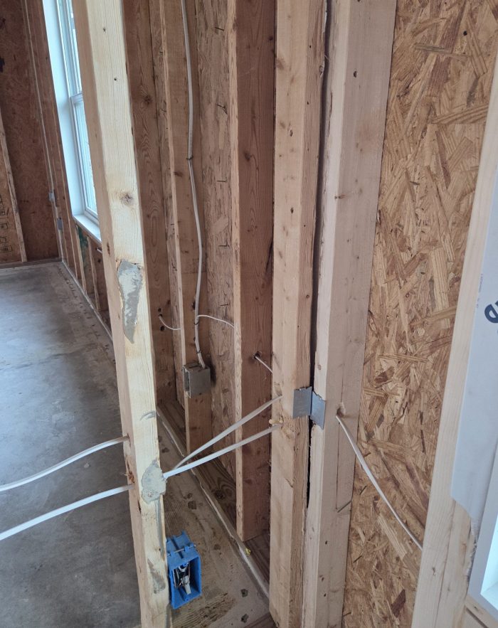

          Our contractor is ok with removing studs on the T junctions so we can get batt insulation behind those wall intersections. He's not a big fan of doing that in the corners (and there were also a couple T junctions that are load bearing that he's unsure about). The exterior is done, so adding insulation there isn't an option. A few follow-up questions:
          1. He might be able to get some canned foam in there - is the high expansion or low expansion better in these areas?
          2. What is the risk we run if we aren't able to fully fill those areas or if there are some we aren't able to get to at all?
          3. If it's better to have redundancy with the air sealing, what should we do if we weren't able to tape the top plates from the exterior? We ran some caulk in the tops of the stud bays and down about 6". Should we add tape on top of that (might be difficult with some nails in those areas)?

            Note that there are different ways to frame a corner. I suggest you look up "advanced framing techniques" to get some ideas. A strip of 1.5" foam can be inserted into a gap left in some of the advanced framing style corners to get a bit better insulation in those areas. Some details allow batts to fit in more of the corner. See which way your GC is more comfortable with.

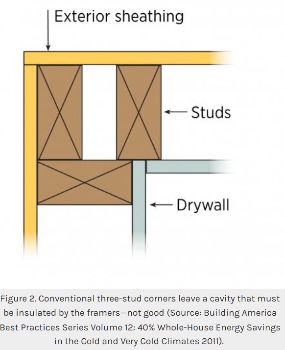

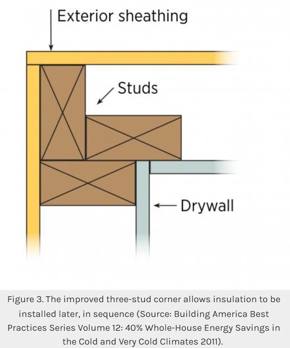

    @tjones1014 - the way high performance builders deal with this detail is to use advanced framing techniques. In your case, at this point you need a solution that minimizes trips for the specialized trades (ie you do NOT want a stud removed so you can insulate and then require the framer to come back and reinstall it; you want only one framer return trip) and maximizes the probability you will get a good job. You are correct to be concerned about this as even in GA lack of insulation in these locations will give you very cold spots. Absolutely get this addressed.

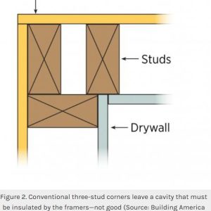

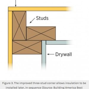

    Here is a link that shows a standard framed corner and then an advanced framing corner from the Building America website: https://basc.pnnl.gov/resource-guides/advanced-framing-insulated-corners#edit-group-description
    If your contractor is willing to remove what is the upper right stud in the traditional diagram, it can immediately be reinstalled in the location shown below it. This will then allow the insulation sub to install insulation into the corner.
    Similarly, here is a link to the advanced framing detail to use when an interior wall intersects an exterior wall, so that you can insulate. This shows the traditional detail, such as you have, first then the advance which allows insulation.. https://basc.pnnl.gov/resource-guides/advanced-framing-insulated-interiorexterior-wall-intersections#edit-group-description
    In this case, implementing the advanced framing detail may be impractical, because it would require moving two studs to which sheathing is already attached, and which may be at the far edge holding the sheathing. If your contractor is willing, perhaps ask him to have the framers turn one exterior wall stud 90 degrees. It could then still support the sheathing, and it would create access for the insulator to properly insulate.
    All the above said, the insulators will need to cut the rockwool insulation to the resulting non conventional cavity size. You will need to watch closely to ensure they do this properly, but I think it is easier to do it properly with rockwool than with fiberglass batts, so you have that going for you.

      For the corners - If my contractor were to remove the stud in the upper right of the traditional diagram like you were talking about, that would involve cutting through the nails that attach the OSB and other exterior items (WRB, ran screen, siding) to the stud. Would that affect the stability of that corner? Both from a structural standpoint and when considering what all might be nailed into it.
      And I'm assuming when it's reattached, we would just nail it into the other corner studs and not bother with attaching it back to the OSB. Is that correct?
  9. user-5946022 | | #22
    So that we are all looking at the same diagram, I've downloaded and attached the Building America Advanced Framing corner details.
    The stud in the upper right of the conventional image is inboard of the corner, so technically it should not be the primary location at which the sheathing is attached. You could figure out if there are fasteners through it by attempting to slide a piece of paper or extremely thin plastic or metal between the outside face of the stud and the sheathing. If you don't hit anything, there should be no issue relocating it. You would relocate it to the location shown on the Advanced Framing image; it is needed at that location so that there is something onto which the interior gypsum can be fastened. Some also believe it is needed to strengthen the corner.

      I’d go back to the advice from Jberks and Bill in the first two posts. Drill a few holes, fill with canned foam, and call it a day. It’s simply not worth the effort involved considering how small the voids are.
