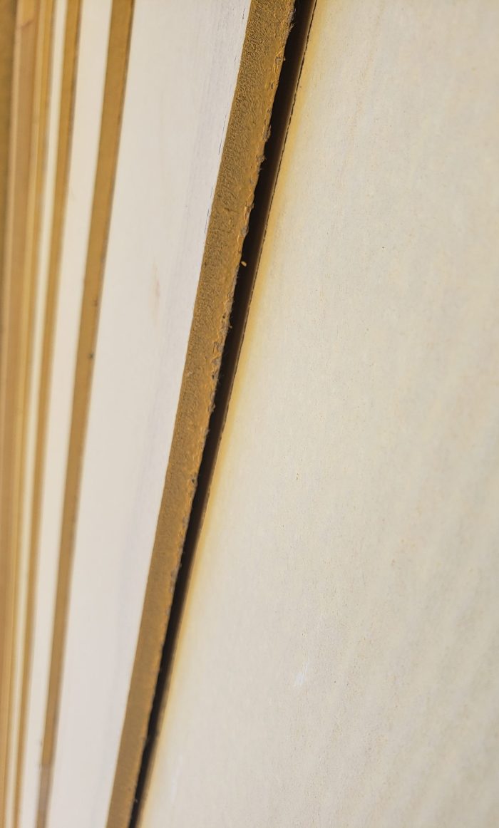

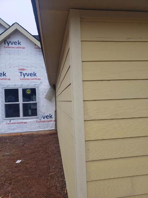

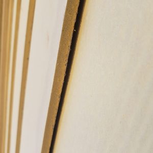

We just had Hardie put up over the top of Benjamin Obdyke’s Slicker MAX (on OSB sheathing), and the walls where there are longer runs look wavy. Pic attached, though it doesn’t quite do it justice.
My siding guy says this is normal. He said, “Typically when the longer boards are installed, you’ll see that. The fiber cement material is meant to be a little flexible so that way it lasts longer and breathes.” Google tells me a different story.
I can only see it when I look at the wall at a certain angle. Is this normal/acceptable? Can this cause more issues down the road?

    There are two types of wavy cement-base siding. The first is when the board has gaps between it and the one underneath due to inadequate fasteners. The second is when the top of the board is wavy due to an uneven substrate, or uneven compression at the fasteners. That second one is what it looks like to me in your photo. The whole flexible/breaths argument is nonsense.

        Always hard to diagnose from a distance, but I suspect their nailer compressed the mesh differently as they sent along the boards. As long as there are no gaps where the boards overlap it's just an aesthetic issue.

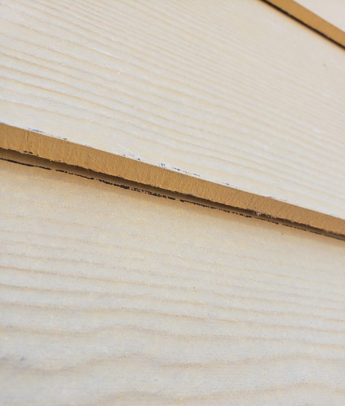

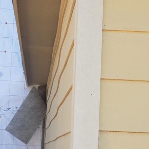

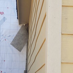

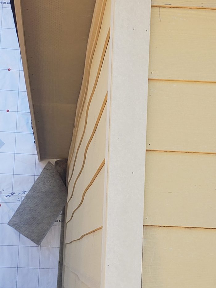

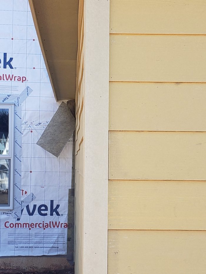

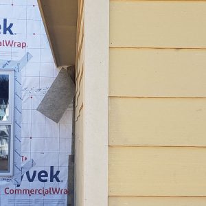

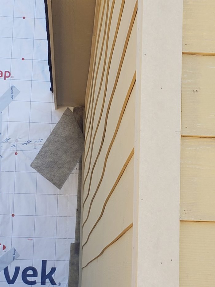

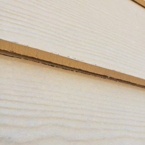

    I was able to grab some better pictures today. There are some gaps between the boards in some places, none larger than 1/8" max. In your opinions, is this still just an aesthetic issue?
