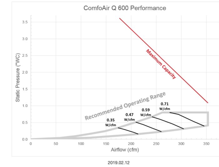

I’ve received a quote from Zehnder for our PGH build in NW Ontario (10,000HDD). They spec’ed the Q600 Comfoair unit to meet our needs. At a max CFM of just over 350cfm it’s grossly oversized (not a bad thing). Zehnder designs their systems to run at medium speed continuous. Our ventilation requirements for the size of home is around 130-160cfm depending what formula you use. Our home will have an interior volume of around 32,000cu Ft.

    Akos | | #2
    What is the w/CFM of the unit in bypass mode? Usually the issue with using an ERV like this is the blower power use is high, CFM is pretty low and not much delta T, the COP is not that great.
    1. JMRtbay | | #3
      Depending on static pressure it looks like the w/CFM ranges from .35 at 175cfm+ up to .71.
      I guess a better question would be: if we are continuously ventilating at the designed rate ~160ish~ cfm how much actually (free) cooling are we receiving with a temp delta of say 15c? I wouldn’t necessarily consider the COP data to be valuable as we would be ventilating at the designed rate regardless.
        Akos | | #4
        160cfm*1.08*24F(15C)=~4000BTU.
        Not nothing but not much. At about 60W blower power, the COP is actually pretty decent.
