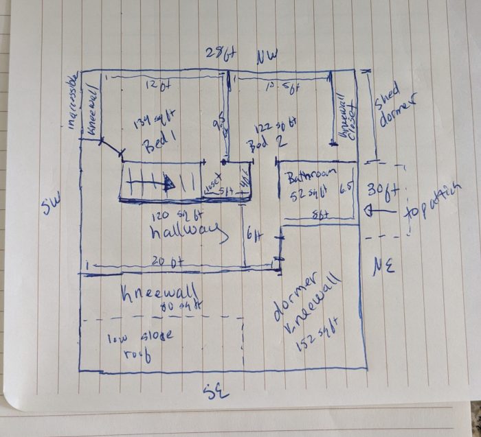

We’ve had a few quotes for heat pumps for our 1947 cape cod (ish) house and are trying to figure out which route to go. The primary issue is that 2nd floor, which has 2 beds and a full bath, has no AC. And it’s uncomfortably warm all year long. We’re hoping to eventually use any system we install for heat too. Right now we have radient baseboard heaters throughout the house for heat. Central AC in the main floor. And two “whisper quiet” window ACs that sound like a large trucks idling in each bedroom on the 2nd floor. The 2nd floor finished area is only about 500sq ft. Because of the awkward layout, every contractor is recommending a ductless head in each of the small bedrooms.
One contractor noted we could do a ducted unit with supply vents in the hallway. The system and ducts would be in our large knee wall/ storage dormer, which is insulated at the roof line, albeit imperfectly. But they felt we wouldn’t be happy with that system because it wouldn’t cool/heat the bedrooms well. There is one NW gable wall in the hallway that could fit a ductless head. But every contactor has raised concerns about the cool air falling down the stairwell before getting to bedroom 1. And having to make a 90 degree turn at the end of a long hallway to get to bedroom 2. Nobody is willing to put a ducted system in the top attic to reach the bedrooms, and obviously ducts in an unconditioned space like that isn’t great anyways. And all the contractors agree there’s no extending the vents from the current central AC to get upstairs unless we plan to do a gut remodel.
I’ve consider stealing a bit of closet that has a small shared wall with the two beds and the hallway to put a mini ducted system in. But the closet only has interior walls, it’s in the middle of the upstairs. So we’d need to use the built in pump for the condense line and I’ve read a lot of negative stories about noise and leaking issues drain pumps can cause. So I’m hesitant about this set up. And we would need to look at other brands of heat pumps/potentially more contactors. The minimum output on the concealed duct units are very bad on the Mitsubishi and not much better than two single Mitsubishi ductless unit for a ducted Fujitsu. We’ve mostly looked at Mitsubishi hyper heat units because it seems the most common that contractors use here. But several also do carrier/Bryant, which seem to have lower minimums. But it also seems like carrier/Bryant isn’t as highly regarded quality wise.
I’ve also considered trying to put one ductless unit in one bedroom and then adding air transfer vents between the two rooms but I worry about noise transfer. The bonus of the wonky layout is that the bedroom doors are far apart and that helps minimize noise transfer. Right now my husband and I use one of the rooms. But within a couple years, we’ll have our 2 kids each in an upstairs room, with us in the main floor bedroom. So maybe we shouldn’t care as much about noise transfer for kids rooms.

I’m going to try to include a picture of a not-to-scale but hopefully close enough floor plan of the 2nd Floor. The ceilings are 7ft high, except the hallway, which is 7ft high for about two ft of width and then slope down to 4ft high for the remaining 4 ft of width. The top of the doors are only a few inches from the ceiling so soffits over the doorways isn’t an option.
I guess my questions are what would you do to get AC/heat to the top floor? (That is not a portable AC unit or window units. I can’t stand the noise of even the “quiet” ones.) Will we regret a multizone for both floors in terms of the higher minimum output even if it’s looking like the most economical option? Any other creative solutions to get right sized equipment for such a small, closed off space that will keep each bedroom comfortable? Any ideas on brands/models that would better suit our multiple low-ish capacity needs?

    I don't think we're going to get sufficient ducts from the basement to upstairs for one ducted system. There actually is one duct chase that goes from the basement to bedroom 2. It blows cold air but doesn't do anything temp wise. We still had to add a window AC (and so did the prior owners). It's flex duct and too small. And there's no return air. There's not really enough return air even for the first floor. One problem trying to get ducts up is the web of pipes for the hydronic heat they have to fitted around. The undersized duct to bedroom 2 can't be made bigger, even if we were willing to make the chase on the first floor larger, because in the basement it's wedged tight in-between a bunch of pipes. 3 contractors all agreed we're not getting ducts up there without significant remodeling. We could seek more opinions.
    The current AC unit for the main floor is 18k btuh. One contractor mentioned that the current set up couldn't handle a larger sized system. Maybe that changes if we add ducts. I suspect redoing the duct work might cost more than replacing the equipment/adding ductless heads upstairs.
