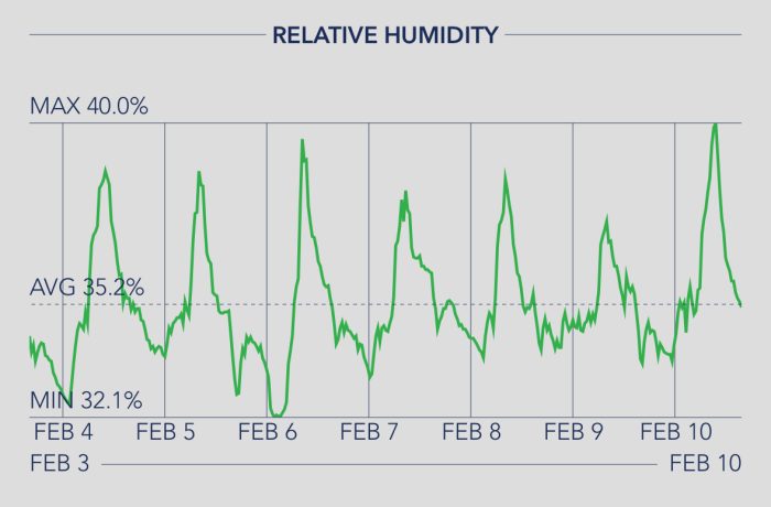

I have a Rheem hybrid hot water that feeds into my bypass 98% efficient furnace. I am in Colorado and I set my humidifier to average 35% (peaks at 40% in the morning dips to 32% at night). After many years of adjustment this seems to be about right for our skin while balancing hot water usage.
However in the morning we can run out of hot water in the morning because of the humidifier uses much of the 50 gallon tank when the furnace goes from 63F at night up to 65F in the morning. During this 3 hour ramp up in temp is when the vast majority of the humidification happens. That also happens to the time when showers are run. I have tried switching the hot water heater to high demand mode for this time of day which helps a lot.

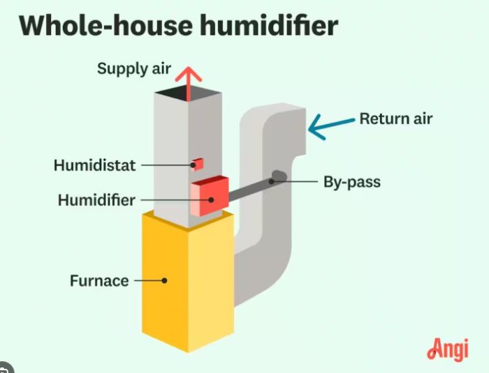

I measured the heat rise of my furnace it it is consistently 55F at all 4 stages of heating on my furnace. My question is if I change the humidifier supply from hot to cold water would my heat rise of my furnace lower because of the cold water running through the bypass making my furnace run less efficiently?

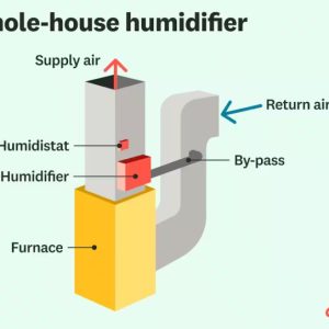

    The heat rise of the the air in your furnace may slightly lower but I don't see how your furnace would be any less efficient. It may need to run slightly longer in order to raise the temperature to the setpoint but it likely wouldn't be much. Is this diagram how you have it ducted? The humidifier is an ultrasonic type? If it is steam you may lose a small amount of electricity heating the water since it won't be partially via a heat pump but instead electric resistance.

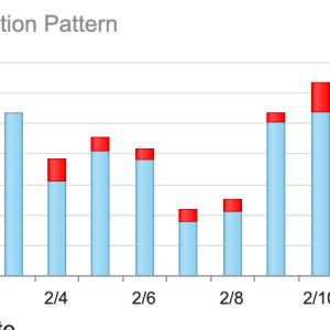

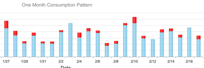

    My town is letting me beta test a new water meter. It seems to track my usage pretty well, but it sees my humidifier as a slow leak. If it is accurate my humidifier uses about 8 gallons a day but sometimes up to 22 gallons. I will turn the humidifier off it is less than 10F outside for the night because of condensation on my windows. After having it off it will use over 20 gallons in a morning to get the humidity back to 35%, that is when I really have shower issues. Also the new meter gives me the temp of the water, in summer it is 69F and in winter it is 42F coming into the house, so the hot water heater has to work a lot harder to make it to 120F.

    Based on the water usage, it appears that at least 95% of the water going into the humidifier ends up going down the drain. So you're wasting a lot of water, and if that water is heated a lot of the energy in it is wasted.
