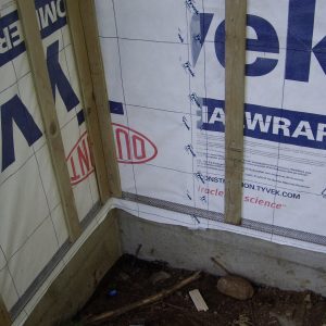

        1. creativedestruction | | #6
          Point taken on the fiberglass, but I'd be surprised to see aluminum mesh "rotting out" unless it's in direct contact with dissimilar metals. Would you mind providing a link to your spiel?

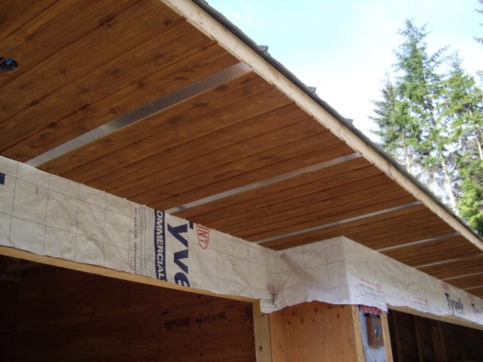

            MALCOLM TAYLOR | | #7
            Jason,
            Once rain-screens were adopted for all residential projects here in BC after being required in our building code, builders quite soon changed from using insect screen to perforated metal flashings. The problem isn't so much the deterioration of the screening, it's mechanical damage (often caused by weeds or grass growing up into the cavity and tearing the screen when removed) , and that the location means repairs or replacement is very involved or impossible.
            Perforated J flashing make strapping easier too, as they provide a channel to set the base into as you are installing it.
            Since they are used so much here they are commonly available at most lumberyards. I use perforated stock a lot. Not just for rain-screens, but also for soffit vents.
            BILL WICHERS | | #8
            Aluminum tends to rot away when in contact with soil in many areas (depending on the soil chemistry), and the detritus that tends to accumulate in these places acts like soil whenever it is moist. This is one reason why aluminum is not permitted to be used for underground ground conductors. It’s not an issue of dissimilar metals contacting the screen, it’s moist materials that react with the aluminum. If the gap never accumulated any detritus and/or doesn’t get wet, you only have to worry about physical damage. In my experience though, detritus always accumulates and can off be moist enough at times to be a problem.
            The fine gauge wires in typical aluminum screen don’t be last very long when exposed to this. The heavier gauge aluminum used in the flashing strips is MUCH more durable. Stainless steel costs more but lasts forever.
          3. creativedestruction | | #9
            Thanks for sharing. The perforated J metal looks to be a tougher product and a good idea. I still wouldn't rule out the aluminum screening if a suitable size of that flashing isn't available. Design landscape control measures for the weeds and of course keep the soil clear. Alkalinity will certainly affect uncoated aluminum and quickly so at thin gauges.
