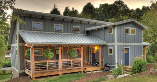

Amy Musser has a PhD in Architectural Engineering and, like me, used to be a college professor. Her husband, Matthew Vande, is an architect with an MS in Architectural Engineering. He is also a treehugger (see the black and white photo below). Together, they founded Vandemusser Design, a firm that provides green design, certification, and consulting. They walk the talk, having designed, built, and moved into their net zero energy home in Asheville, North Carolina.
They gave an evening presentation on their home at this year’s RESNET conference, and this net zero home is impressive. I’ll give you an overview here, and you can get more detail from their presentation, which you can download in pdf form from RESNET’s site. If you know about HERS ratings and the HERS Index, you may be surprised about one aspect of this home.
I travel up to the North Carolina mountains frequently and hope to visit their place on one of my trips this year. (Of course, this was news to them when I first posted the article in the Energy Vanguard Blog, since I hadn’t asked them yet. Nothing like publicly inviting yourself to someone’s home, right? Fortunately, they responded positively!) The photo below shows the front of their home in its natural habitat. (As far as I know, it never leaves that habitat, but with a net zero home, you just never know.)
About their home
They use the building both as their home and their office. They live upstairs and the office is in the basement. It’s 3,100 square feet total. Other features include:
  • All electric
  • HERS Index 44 before solar
  • HERS Index 12 with solar
  • IECC climate zone 4
  • True net zero performance (see next section)
  • Multiple certifications (which we sometimes call a NASCAR house): LEED for Homes Platinum, ENERGY STAR, EPA Indoor AirPlus, NC Healthy Built Platinum.

Highly insulated basement walls. They used the Superior Wall system, as you see in Image #4 below. They’ve got R-12.5 continuous plus R-19 cavity insulation. Nice!
Passive solar. South-facing windows with high solar heat gain coefficients (SHGC = 0.53) and low SHGC (0.23) on other sides of house. Slabs for thermal mass in basement and first floor.
Reduced thermal bridging. They paid attention to the details, especially the band joist and the rafters. Remember that article I wrote about a sword through the ribs of the building enclosure? Well, they didn’t do that. Instead they stopped the rafters at the enclosure and then lagged rafter tails onto the outside. Voilà.
Structural insulated panel (SIP) walls and roof. They used urethane foam instead of the more common expanded polystyrene (EPS). It has higher R-values, R-24 in the walls and R-38 in the roof.
Ground-source heat pump. Expensive but offset by lots of incentive money. Capable of distributing heating and cooling either through radiant tubes or through air ducts.
Radiant heat. This didn’t save them any energy but they did it anyway for comfort reasons.
As I mentioned above, the HERS Index for their home is 12. Theoretically, a net zero energy home means that the HERS Index will be zero. Their score of 12 means that they’re 12% less efficient than a net zero home. Or so we’re told anyway.
They may not have reached the theoretical net zero of a zero HERS Index, but in terms of performance, they’re net zero. In their first year in the home, here’s how they did:

In their RESNET presentation, Amy and Matt were honest about what they saw as their mistakes. Having lived in the house for a couple of years now, they see things that didn’t quite work out. They’ve also looked at the numbers and found what wasn’t as cost-effective as they hoped it would be.
  • The mechanical room is too small. This one happens everywhere. I’ve rarely been to a house where the designers allocated enough space to the HVAC and water heating systems. And theirs, as you can see in the photo here, is downright spacious compared to some of those little closets I’ve seen that are jam-packed with equipment and ductwork.
  • SIPs are not cost-effective. They calculated that it cost them an extra $12,000 to use SIPs and netted $5 of annual savings. The simple payback on those numbers yields 2,400 years. (I like SIPs and the payback for the house I built would have been much more favorable if I had calculated it.)
  • The fireplace is not used. They’ve had one fire in two years in their home, “mostly out of guilt,” and found that it overheated the living area. They may have saved that $5,000 if they were doing it over.
By eliminating the SIPs, fireplace, radiant heat, rainwater harvesting, and using an HRV instead of an ERV, they calculate that they’d have saved over $41,000. That would have dropped their square foot costs from $156 to $143 and still gotten the same performance. (Those costs factor in the incentives.)
