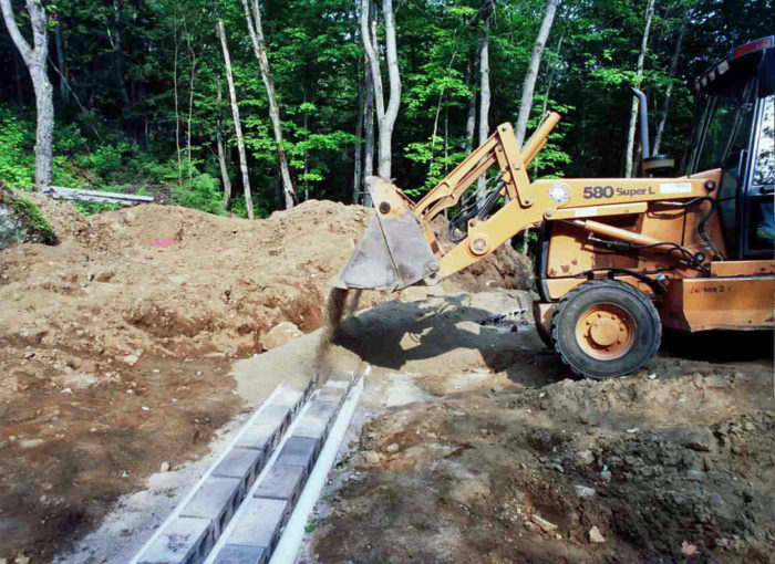

The deeper you bury your earth tubes, the better the tubes will perform. In the middle of winter, the soil temperature five feet below grade is significantly warmer than the average winter air temperature. And in middle of summer, the soil temperature is cooler than the air temperature.

An earth tube is a buried ventilation duct. The idea behind burying ventilation ducts — the ducts conveying fresh outdoor air to a building — is that the soil surrounding the ducts will warm the ventilation air during the winter and cool the ventilation air during the summer.
Earth tubes can work, as long as:
  • the duct is installed in a climate with useful soil temperatures,
  • the duct has a large enough diameter,
  • the duct is long enough,
  • the duct is buried deep enough,
  • the duct is installed in a way that minimizes potential condensation problems,
  • the duct is able to exclude radon.
That said, earth tubes are expensive to install, so they are rarely a cost-effective way to condition ventilation air.
Poorly designed earth tube systems are probably more common than well designed earth tube systems, which is why many earth tubes are eventually capped off and abandoned. If you are considering installing an earth tube, it’s worth learning about what works and what doesn’t.
