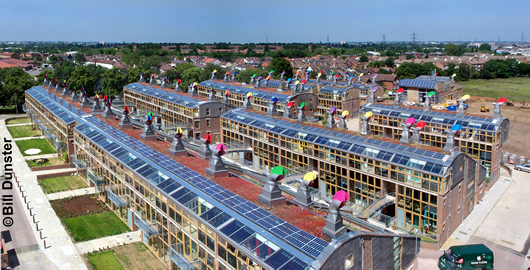

The Beddington Zero Energy Development, or BedZED, in Wallington, South London, is touted as one of the best known examples of sustainable living in the U.K. Designed by Bill Dunster Architects and completed in 2002, the 100-home community was developed by the Peabody Trust housing advocacy group in partnership with BioRegional Development Group, an entrepreneurial, independent environmental organization. Homes in the community, whose heating requirements are about 10% of those of conventionally built dwellings, have become sources for training and research for energy efficient building and operation.
Image Credit: Bioregional Development Corporation
