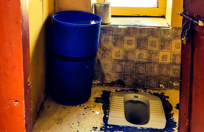

A bathroom in a tea house in Dingboche, Nepal, is a good illustration of how some building elements in underdeveloped countries differ so dramatically from those in the U.S., and why a different sort of green building certification system makes sense.
Image Credit: Stuart Kaplow
While Nepal is breathtaking, containing eight of the world’s ten tallest mountains, the country is landlocked to the north by China and to the south and east by India. It’s a developing country with a low-income economy, ranked among the poorest of the 187 countries in the U.N. Human Development Index.
Writing this post from Nepal, I think that it seems appropriate to discuss EDGE.
EDGE (Excellence in Design for Greater Efficiencies) is a green building certification system for new residential and commercial buildings in emerging markets and developing countries. Yes, think “like LEED” for the other 70% of the world.
EDGE certification is available in over 120 countries around the globe, from Afghanistan to Zimbabwe. The list includes Nepal, but not developed nations like the U.S.
The photograph above was taken at a popular tea house in Dingboche, Nepal. It shows why LEED-type notions of interior water use reduction (e.g., WaterSense flush toilets) and energy reduction (e.g., LED lighting) have little if any application for the majority of buildings in most developing counties, where squat toilets with a bucket of water are the norm and the only illumination is daylight from a window.

    I've been to Dingboche, marketability isn't in their equation
    I think Stuart's ideas will apply in the major cities/towns of 3rd world countries in the sense that they can save money. Nepal might not be a good example. When you get higher than Dingboche, the heating fuel is animal dung, the walls are stone, and the framing is hand hewn timber.
