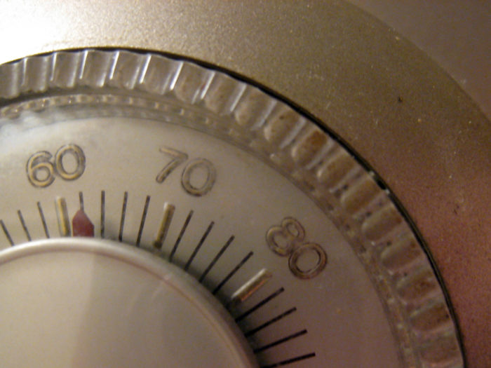

Last Monday, scientists in the journal Nature Climate Change answered a nagging concern of practically everyone we know: why are offices and buildings so ridiculously over-air conditioned? The article reports the design of office buildings incorporates a decades-old formula, a significant part of which is based on the metabolic rates of the average man.
In other words, buildings are constructed so that a man weighing about 154 pounds feels comfortable while he is doing a desk job. This goes far beyond setting thermostats — that would make it easy to fix.
It does involve permanent building choices such as equipment much bigger than needed. As the study’s authors point out, over-designed systems lead to the very noticeable over-cooled result.
To be fair, if you read the references to the article, the guiding standard, ASHRAE 55-2010, (ASHRAE: American Society of Heating, Refrigerating, and Air-Conditioning Engineers) does not force anyone to plug a certain metabolic rate into the equation. It simply recommends values. It became the default standard for construction.
A behavioral scientist, or anyone who has keeps a wool jacket at work in the middle of summer to counter an incredibly cold office, can tell you that the power of this recommendation is huge.
The ASHRAE recommendation is a massive nudge in the wrong direction — not good for energy efficiency and perpetuates an outdated work environment.
