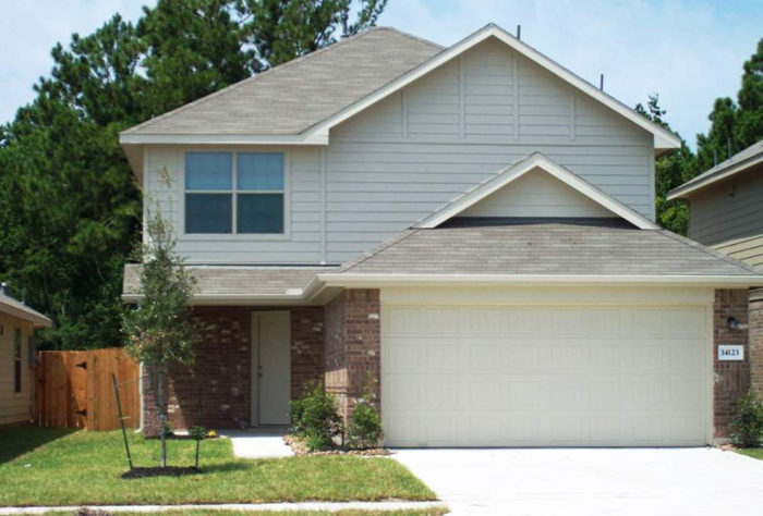

Disappointing Energy Savings for Energy Star Homes
A Houston study shows that homes without an Energy Star label perform almost as well as Energy Star homes
How well do Energy Star homes perform? In recent years, about half of all the new homes built in Houston — including this charming garage-forward beauty built by Lennar Homes on Astonshire Street — have received an Energy Star label. On average, these homes use about 2% less electricity than comparable new homes without an Energy Star label.
Image Credit: Movoto.com
