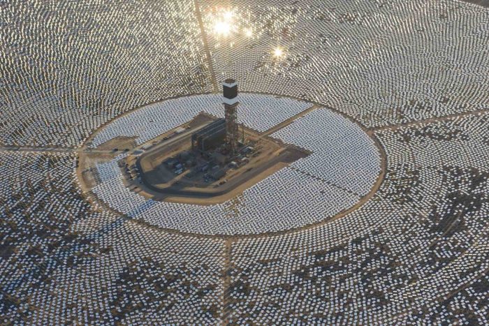

Solar power is better than fossil fuel power generation from the perspective of carbon emissions, but large-scale solar, like the Ivanpah solar electric project in California, require large tracts of land and can have a negative impact on local species.
