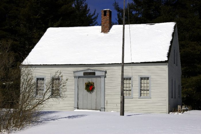

New England is full of old, leaky homes. It also has more than its fair share of new, leaky homes.
Image Credit: Public domain photo from MorgueFile
Home energy audits in cold, northern climates are very different from those in hot climates. Different regions of the country have different types of housing stock, and there are regional variations in insulation methods and mechanical systems. In older houses, the type of weatherization work that has been performed varies greatly from region to region.
