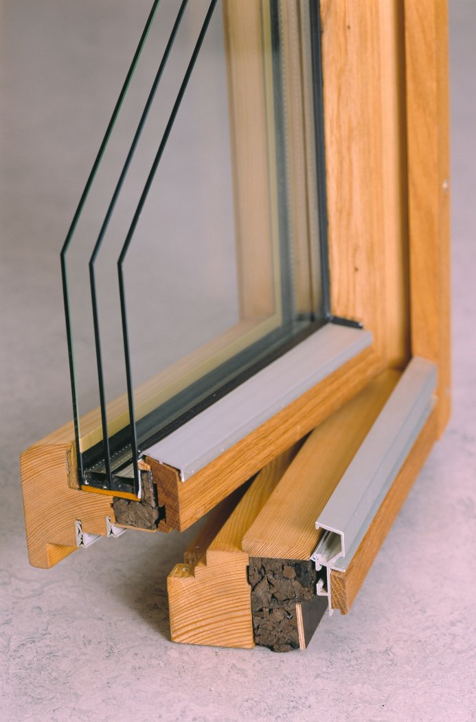

This German-made triple-glazed window uses cork insulation as a thermal break in the frame and sash.

Designers of high-performance homes know that there is always more than one way to reduce energy use. It can be daunting to optimize investments in energy-saving measures: even with the help of computer modeling software, designers need to exercise judgment.
Designers face such questions as: Does it make more sense to upgrade the attic insulation from R-40 to R-60, or to upgrade the water heater to a more efficient unit? Does it make more sense to upgrade from double-glazed to triple-glazed windows or to upgrade from a gas furnace to a ground-source heat pump?
