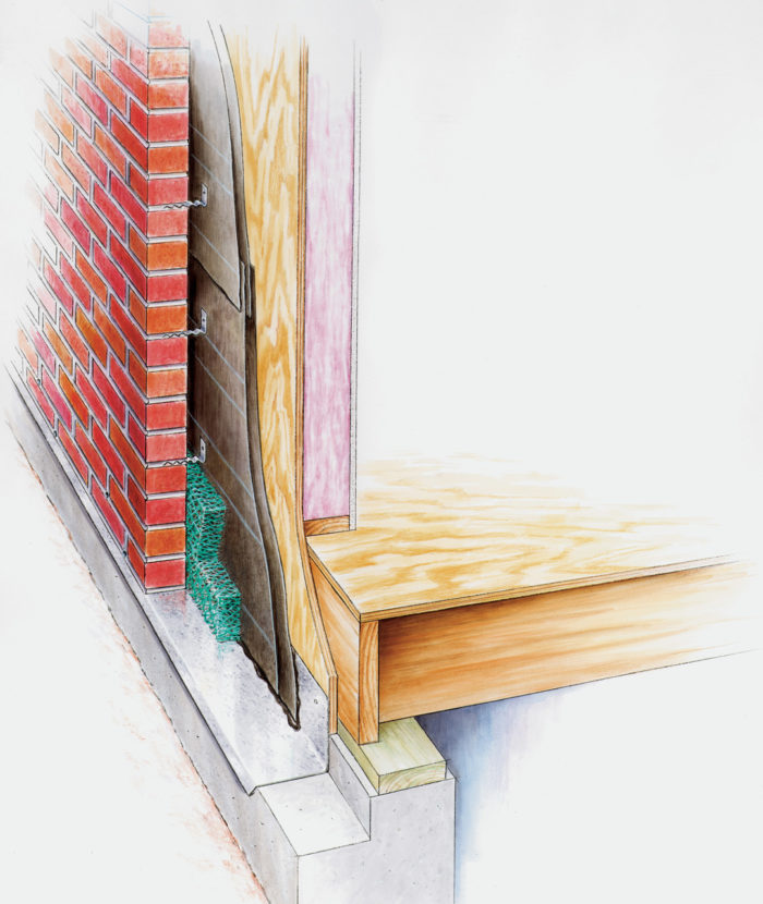

Since rain can easily penetrate a single wythe of brick veneer, masons need to anticipate water entry. A free-draining air space, a well-lapped water-resistive barrier (WRB), durable through-wall flashing, and open weep holes at the base of the wall are all essential elements of a brick veneer job.

    Because it's all but impossible to build brick veneer without spilling mortar down the space behind it, I believe it's essential to use a "bottom of cavity drain maintenance material". There are a number of options including keystone-shaped mesh pads, corrugated styrene, and non-woven gap material. We often use 3/16 non-woven gap material with a fabric scrim for the bottom 12-18" of a cavity, this has the added advantage of preventing capillary conduction of water via the mortar, since it maintains a gap between the droppings and the WRB and sheathing.

    Some day I may see a brick veneer installed with a full 1" behind it, or even 2"...but I have never seen that yet either in new work or in old. Even the BIA calls it a 1" nominal air space. I think the key is keeping drainage open at the bottom and minimizing capillary moisture transport, and 3/4" +/- is just fine.

      The overwhelming majority of wetting and dryjng on brick veneer walls occurs by vapour movement through the bricks, not air movement in the cavity. The weep-holes are too small to be effective in creating a ventilated gap, and I'm not sure adding them to the top would help that much. If you wanted to effectively vent the top of the wall, you need some detail that leaves the whole gap open. As Martin says, their main function is to drain any water that makes its way into the cavity.
      The weep-holes are protected by small mesh screens which sit where the mortar between the bricks would usually be. They can be bought at masonry suppliers, and probably online.
