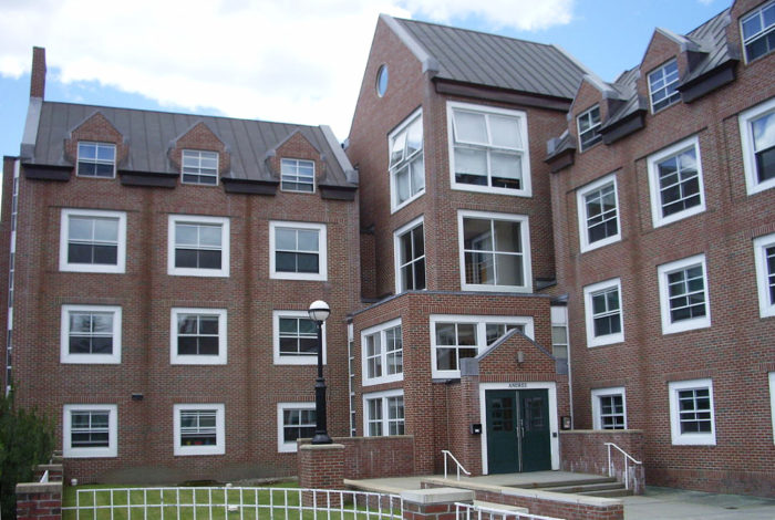

This four-story brick building, Andres Hall, was built in Hanover, New Hampshire, in 1987. The college dormitory was designed by Herbert S. Newman Associates of New Haven, Connecticut.

The design of brick buildings and the quality of brick construction have declined dramatically in the last 100 years. While this statement is debatable, I’ll try to defend it with evidence. If my evidence is compelling, it raises questions about why certain technologies advance in sophistication while other technologies decline.

  1. Paul Eldrenkamp | | #1
    which came first: the architecture or the brick?
    In the bank building, the brick and the architecture are interdependent. That kind of architecture can only be executed in brick, and the brick in turn makes the architecture possible.
    In the dorm, the brick is incidental to the architecture -- that building could have gotten almost any cladding and it would not have mattered much to the architecture. What it got was tantamount to wallpaper printed with a brick pattern. It's curtain-wall brick. It's just there to provide a color and texture that panders to what people think a New England college dorm should have for cladding.
    If your brick cladding is functioning primarily as wallpaper, it's hard to care about getting the details right.

  3. user-1072251 | | #3
    Stains where water dribbles
    Stains where water dribbles down facades is ubiquitous in modern masonry buildings - so is it an all too frequent design flaw? Perhaps it's an intentional design statement (although I can't imagine what they are saying).
  4. GBA Editor
    Martin Holladay | | #4
    Response to Bob Irving
    Bob,
    The phrase "an intentional design statement" seems to me to be a particularly charitable explanation for these ubiquitous examples of architects' ignorance and incompetence.

  9. user-5283384 | | #9
    Not just brick
    This "disposable" view of houses and buildings has been prevalent since at least the post-WW2 boom in both population and housing. I often lament the poor quality of commercial buildings that are constructed today, but then I realize the mall/restaurant/apartment building will be bull-dozed in 30 years, so why bother with quality?
    There are numerous other egregious examples of the devolution of construction. Roofers frequently tear off 125-year old metal roofs and replace them with asphalt shingles. Roof-lines are built with little concern for how the gutters can handle the volume of water. Houses are built on flat or sunken lots which afford almost no opportunity for proper grading. Obviously I could continue, but this exercise presents no challenge and is therefore boring me!
    In defense of the building industry, we are building exactly what the public has demanded. They want really big, spacious houses at a very low cost. Something has to give. The customer that comes to the builder and says, "I want a 1,400 SF house built to last centuries and with the utmost quality and efficiency" almost doesn't exist.
  10. GBA Editor
    Martin Holladay | | #10
    Response to Kevin Miller
    Kevin,
    I agree that we can come up with many examples of declining quality in residential (and commercial) design and construction. (Fortunately, some details, like airtightness details, are getting better.)
    But I don't think that it's true that "we are building exactly what the public has demanded." I think that most home buyers who spend $300,000 for a new house assume (a) that the house is "built to code," (b) that the house "has passed inspection" (whatever that means), and that (c) the house will last for many, many decades.
    Homeowners don't know how to assess design quality or construction quality, and can't be expected to. However, homeowners want quality buildings, not junk. They tend to learn about the defects in their homes soon after their new home warranty expires.
    Automobiles have gotten a lot better over the last 30 years, and car buyers are glad of that. (These changes did not occur because car buyers took courses in automotive engineering and assessment; rather, the manufacturers stepped up to the plate and introduced improvements.) If similar changes were to happen in the home building industry, home buyers would be pleased at the changes. It just hasn't happened yet.
    While it's true that homeowners can't be expected to assess design quality or construction quality, the same cannot be said for Dartmouth College, home of the Thayer School of Engineering. If an Ivy League college with a multi-billion-dollar endowment is willing to accept low-quality buildings from the architects and contractors they have chosen, shame on Dartmouth.
    You wrote that many commercial buildings are designed to be "bulldozed in 30 years." If that is Darmouth's plan, then Andres Hall is nearing its deadline, and will be gone in 2017. However, I don't think that is part of Dartmouth's plan. Many brick buildings on the campus are well over 100 years old, and look a lot better than Andres Hall.
