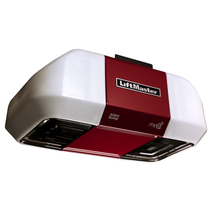

According to the manufacturer, the standby power draw of the LiftMaster 8550 garage door opener is about 1 watt. Older garage door openers have a standby power draw as high as 14 watts.
Image Credit: LiftMaster
If your home has a garage, there is a good chance that you have an automatic garage door opener. Because these electrical appliances operate for only a few minutes per day, they don’t use much electricity to open and close your garage door. But there’s a catch: most garage door openers use three to five times more energy during the 1,437 minutes per day when they are “off” than they do during the 3 minutes per day when they are on.
Like any appliance that has a remote control, a garage door opener is always on. Even when it isn’t operating, it is warm and humming, listening for the radio signal that will tell the machine to spring into action. This type of electrical draw is called a “phantom load.”
Back in the 1950s, electrical appliances didn’t have phantom loads. When you turned them off — by flipping a toggle switch or knob that made a satisfying click — they were really off. Since then, however, appliance manufacturers have gotten sneaky. Even though the switch position may be marked “off,” the appliance is still warm. The only way to really turn it off is to pull the plug out of the wall.
Appliances with phantom loads include anything with a remote control, as well as any appliance that has a clock display or glowing LEDs. Appliances with phantom loads include a few obvious candidates, like set-top cable boxes, and several less obvious ones, like some washing machines and kitchen ranges.
In 2002, Mark Pierce, an energy expert at Cornell University, estimated that phantom loads cost the average U.S. household $200 per year. Other estimates are much lower, ranging from 329 to 569 kWh (about $40 to $70) per year. According to a web page on phantom loads maintained by the…

    We have the LiftMaster 3595 (3/4 HP) and it draws 3W.
    On a related note, you know you're an energy-efficiency geek when you leap out of your chair and hunt for your Kill-a-Watt to measure the phantom load of your garage door opener, all before breakfast.

    It's so nice to know there are other geeks who measure garage door idle power. ;) Back in 2010 I measured my LiftMaster (sorry, not sure which model) at 3W as well.

    Another great article, Martin. I too immediately dug out my Kill-a-Watt meter and plugged it in to my garage door opener. I also hadn't thought about measuring it. We have a pretty old Stanley 1/2 hp opener and I thought I would have very high standby power readings. This is what I came up with.
    Standby: 0 watts
    Operating: around 490 watts
    Closed with the lights on: 175 watts, I have (2) 100 watt light bulbs in it. (not good, I know) :)
    After 8.5 hours of sitting idle the total KWh reading was 0.00
    Is the standby power so low that it doesn't register with the Kill-a-Watt? It has a remote so it must use some power all the time, right?

    Todd. The Kill-a-Watt meter is a very good tool, and accurate to 0.2% plus or minus 1 Watt. This means at the bottom end of its range it can be off by about 5 Watts. When I need very low Watt measurements I use an old electro-mechanical power meter, and loop the current sense wire through the current transformer ten times, then divide the reading by ten.

    In the body of the article, Martin describes GBA reader Curt Kinder calculating the phantom draw of his 3 garage door openers at 5 kWh/day, which is an eye-poppingly huge amount.
    He then, however, describes the measured phantom draw of those three units at 14.5W apiece.
    I'm no mathematician, but 14.5W per unit x 3 units x 24 hours per day is 1044 Wh... or 1 kWh. Not 5 kWh.
    What's wrong here?
  20. GBA Editor
    Martin Holladay | | #20
    Response to Chris Conti
    Chris,
    The table in this article accurately reports that one of Curt Kinder's garage door openers uses 127 kWh per year. That amounts to 348 watt-hours per day (if you divide 127 kWh by 365 days per year). So three such garage door openers use 1,044 watt-hours per day. Your numbers and my numbers agree.
    The 5 kWh per day is Curt Kinder's report of the total electricity used at his house for phantom (standby) electrical loads. His garage door openers only account for about 20% of these phantom loads -- the rest of the loads are from doorbell transformers, cable boxes, security system electronics, wall cubes for electrical gadgets, and other standby loads.
