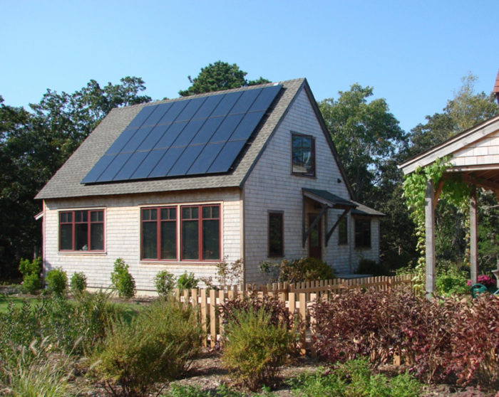

Solar arrays can meet all of a home's energy needs. Eliakim's Way is a neighborhood of all-electric homes on Martha's Vineyard in Massachusetts. The homes use roof-mounted PV modules to generate most (or all) of the residents' energy needs on an annual basis.
Image Credit: South Mountain Company
