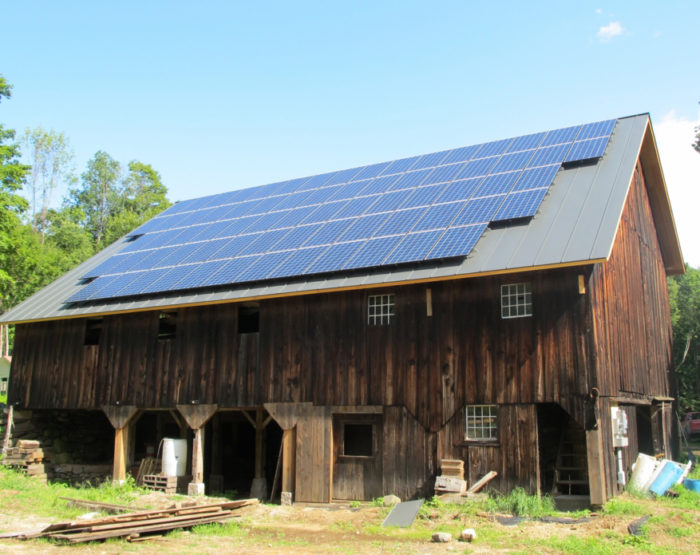

The 18-kW photovoltaic array on our barn is a group-net-metered system with some of the output going to other houses.

We have three inverters in our system that are housed in a downstairs room in the 1812 barn. The one with Secure Power Supply is the third from the right. Our Sunny Boy 5000TL-US inverter. The outlet beneath it provides emergency power during outages (when the sun is shining). Comparing the new transformerless inverter (on the left) with the standard Sunny Boy inverter Our PV array being installed. The barn roof was structurally reinforced and covered with standing-seam metal roofing.

Given my focus on resilient design (including my founding of the Resilient Design Institute last year), I wanted to install a solar-electric system at Leonard Farm that would have at least some functionality during power outages.

    Someone else owns 6Kw of your 18Kw system? How does that work? Do they somehow get 2/3 of the power or does your local utility company somehow split the compensation or do you pay them some amount for 1/3 of the power or what?
  11. Alex Wilson | | #11
    Group net metering
    Brian,
    We are lucky in Vermont that state law requires utility companies to provide what is referred to as "group net metering," and our largest utility company in the state, Green Mountain Power, has been very supportive of this practice, even before it was mandated. There is only one meter for the electricity feeding into the grid from our system, but one-third of that electricity is apportioned to our neighbor. He will see that solar electricity credited on this electric bill.
    Of the 12 kW that my wife and I own, we will work out contracts to provide a portion of that to one or two other Green Mountain Power customers, since we won't require that much electricity--at least initially. When the farm is fully up and running we may be needing most of that power, depending on coolers, freezers, and other electrical loads.

    There are three inverters serving the 18 kW array. Two are standard 6 kW Sunny Boy inverters and each of those has 26 250W modules connected to it (two strings of 13 modules). The third inverter is the specialized unit that offers some power when the grid is down; that one is a 5 kW inverter and it has 20 modules feeding into it (two strings of 10 modules each). SMA doesn't currently make a 6 kW TL inverter. SMA technicians advised our installers, Integrated Solar Applications, on configuring the module strings as they did. (Our total system output won't be affected even though the combined rating of the inverters (17 kW) is less than the rated peak output of the modules (18 kW), since the modules will never provide their peak output, and inverters can actually handle more than their rated output.)
    So, the power we have access to during an outage is only coming from the one 5 kW inverter that has modules with a peak rating of 5,000 watts connected to it. Similar emergency power would be available from a more typically sized array, and we could have had more emergency power available had we had installed three of the TL inverters. (The decision to try one of these new inverters was made late in the process.)
