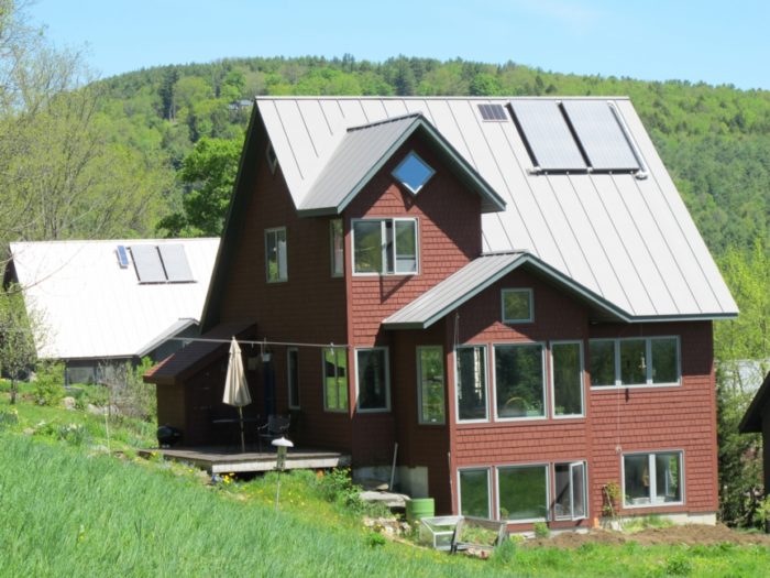

Deep overhangs and standing-seam roofing are among the features of the homes at Cobb Hill Cohousing that will help to ensure a long life.
Image Credit: Alex Wilson

  • Provide deep roof overhangs to keep moisture away from the walls and foundation.

Fiber-cement siding, for example, costs a lot more than vinyl siding, but it should last a lot longer. The same goes with high-quality, standing-seam metal roofing or slate shingles, compared with asphalt shingles. There is usually a higher up-front cost for more durable materials, but that extra cost is repaid over the long term—both monetarily and environmentally.
