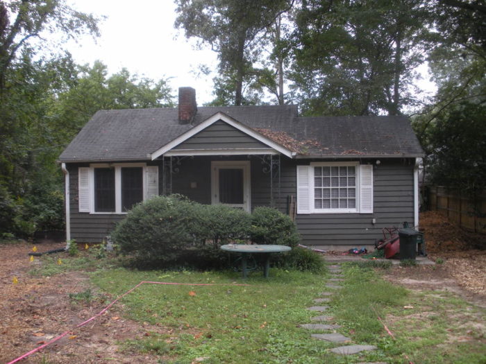

There is an existing cottage on the property that I was planning to demolish after my new house is complete. I was told by the commission staffer that the cottage is considered a “contributing structure” to the district, and I would have a hard time getting approval to remove it.
Setting aside the fact that I was told exactly the opposite several years before and the issue never came up during an earlier review of my plans, the cottage may be old, but calling it historic, let alone even a house, is a bit of a stretch. While currently all of 700 square feet, the original house was barely more than 400, having undergone two additions and the replacement of the front porch floor and columns sometime in the mid-20th century. It has been classified in a recent historic survey as an “American Small House” , while I would venture to say that it is more of a shack than a house.
Limited options
While I will still argue my case to remove the cottage and replace it with a modest carriage house with an apartment, I have to plan for the possibility that I will need to keep it.
My first backup plan is to remove the additions and relocate the cottage farther back on the property to turn it into a garage. This will be extremely costly and provide me with a garage with no apartment above.
Farther down the list is to move it as-is and keep it as a rental property, with no garage. This last option is what causes me the most distress. The cottage has wood lap siding attached directly to the studs with no wall insulation. While terribly inefficient, this construction is durable and makes the walls very resistant to mold and rot with excellent drying potential. Having lived in this structure for several years, I am acutely aware of its problems and wish none of them on future tenants.
I am, however, very reluctant to insulate the existing walls, as this will almost certainly cause new moisture, air quality, and durability problems — unless of course, I remove all the siding and windows, install a complete weather barrier, and reinstall all the siding. If not, the building will continue to be profoundly inefficient and uncomfortable for anyone living there. Do I spend the money required to do this so that I can rent it in good conscience, or just leave the structure unfinished and unoccupied and use it for unconditioned storage?
