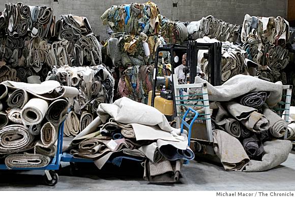

Carpet recycling in the Bay Area of California
Image Credit: Michael Macor - The Chronicle

Tearing carpet out
This can be a nasty job and the path to the dumpster almost irresistible. But we toss more than 2.5 million tons of carpet a year in this country and lots of work has been done to make recycling of carpet and carpet pad possible.
In 2002, the carpet industry, key government agencies, and non-profit environmental organizations, created the Carpet America Recovery Effort (CARE). CARE has always had ambitious goals for carpet diversion, starting with 40% by 2012. CARE’s latest report shows a total diversion rate in 2009 of around 25%.
There are currently 72 CARE reclamation partners in the US; you can find the one nearest you using the interactive CARE map. Many CARE locations also take carpet padding. There is also an interactive location tool for carpet and carpet padding recycling at Earth911. If you don’t find any carpet or carpet pad recycling facility within striking distance, talk with your local municipal recycling or solid waste coordinator. It may be possible to work with your town or city on a collection location that then trucks the material to an existing facility.
Recycling costs for carpet and pad are high; while it may be cheaper to recycle than to toss in the landfill, the materials are not high enough in value to mean you will get paid for the material.
