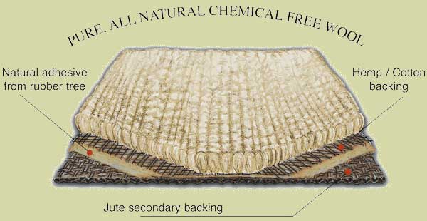

An ideal construction diagram for environmentally preferable carpet that's healthy, too!

Carpet is two-faced. Check the content literally from front to back, as the carpet backing is equally important as its face. Look for backing made from natural latex, rubber, hemp, cotton, and jute, all of which can come from nontoxic, renewable sources.
If the products are made from natural raw materials and contain no added toxins, they can biodegrade responsibly at the end of their life.
Ensure healthful carpet installation by using tack strips instead of adhesives, which can be loaded with VOCs and make the carpeting harder to remove/replace/reuse/recycle later on. Padding increases softness and the carpet’s life, so, again, look for natural wool and rubber; there are many made from recycled products.
