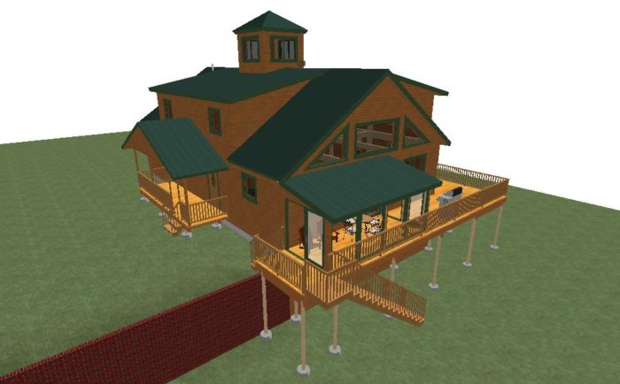

A building project in northern Vermont will include a structural insulated panel (SIP) roof, but sealing potential air leaks may be difficult.UPDATED on July 7, 2011 with comments from Tedd Benson
Jay Hersh is building a house in northern Vermont that will have a roof of structural insulated panels. Although his plans are fairly advanced, Hersh is still stumped about detailing the SIP seams to prevent the migration of moisture-laden air from inside to outside. He’s also looking for a foolproof way of heading off any leaks from the outside.
This strategy, as he explains in this Q&A post at GreenBuildingAdvisor, involves the installation of a membrane (as yet unidentified) between the tongue-and-groove ceiling and the roof SIPs, and another membrane between the top of the SIPs and the standing-seam metal roof.
Suggestions to date for the roof underlayment on top of the SIPs include asphalt felt, RoofTopguard, or Grace Ice & Water Shield. He’s not sure what type of membrane to use between the ceiling boards and the SIPs.
Hersh asks for advice, and the resulting discussion is the subject for this week’s Q&A Spotlight.

One complication to air sealing on the interior is the tongue-and-groove ceiling.
“The SIP installer intends to put the T&G ceiling boards down on top of the frame before the roof SIPs go on since it’s a lot cheaper, faster and easier to do it that way than to install them on the underside of the SIPs,” Hersh says. “Also, it means the SIP doesn’t get perforated.
“So I’m confused about the suggestions to tape & foam the interior, since I don’t see how the interior seams can be accessed if the SIPs are going down over the T&G boards. I’m pretty sure that’s why they recommended some type of material be placed over the T&G boards.”
That’s going to make it tough to get a good air seal, Holladay says, because you won’t be able to tape the interior seams of the panels.
“Experience has shown that foaming the seams is insufficient to attain high levels of airtightness,” Holladay writes. “Although taping the exterior seams is a good idea, you could still end up with interior air circulation through convective loops at your SIP seams; when this looping air contacts cold surfaces — the exterior tape — condensation and rot can occur.”
Although adding a layer of Tyvek above the T&G boards might work in theory, the idea has some practical shortcomings: it will take a lot of fasteners to hold the slippery Tyvek in place, each one of which is a potential air leak, and the Tyvek would have to be bonded to the air barriers in the walls perfectly. “That idea contains a lot of opportunities for failure.”
Instead of Tyvek, Rooks suggests another product he sells: Siga Majpell, with a perm rating of 0.68, or a similar CertainTeed product, MemBrain, held on not with nails but with double-sided tape.
