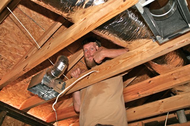

Have I mentioned that New Orleans is a hot and humid climate? Here, my colleague and good friend, Paul Bobbitt, installs a rigid bath fan duct in the Big Easy.
