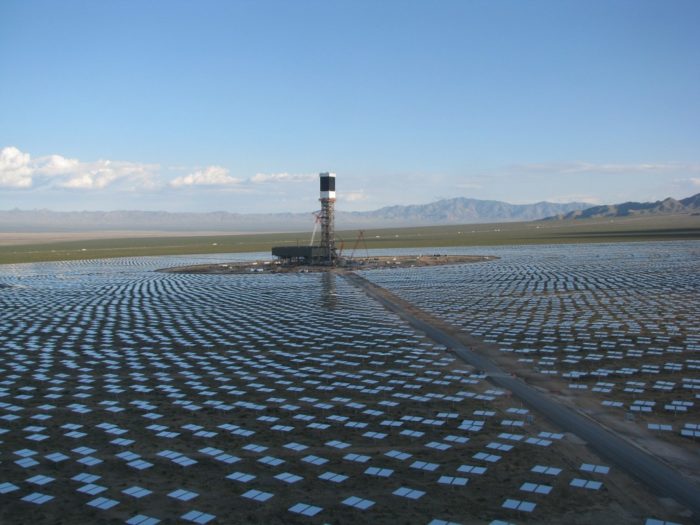

The Ivanpah solar project in California's Mojave Desert uses heliostats to concentrate sunlight on boilers atop three towers. The 392-megawatt project covers 4,000 acres.
