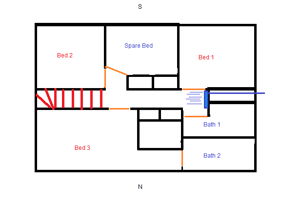

Like many houses built in the 1960s, Nathan Efrusy’s 2,000-square-foot colonial in Detroit has baseboard heat but no central air. A single wall-mounted air conditioner keeps the first floor of the house comfortable, but Efrusy would like to extend AC to the second floor — the question is now to do that effectively.
In a Q&A post, Efrusy says he’s been given several options for cooling on the second floor, but he’s leaning towards a ductless minisplit.
“The main challenge is the layout,” he writes. “It’s essentially a 16-foot hallway with four bedrooms off of it. Originally, we were quoted for a four-zone system, with a head in each bedroom. However, after further reading, it seems that design would be overkill… especially after getting a cooling load calculation of roughly 10,000 Btu/h for the entire upstairs!”
Efrusy assumes he would be running the minisplit continuously in order to keep the second floor dehumidified and between 72°F and 76°F. Bedroom doors could be left open during the day.
“So the question is, how well would a single 9,000 Btu/h minisplit be able to cover the upstairs of our house?” he asks. “My hope is that we wouldn’t need additional fans to push the air into bedrooms. Would there be enough cooling through convection and the internal walls to combat the heat entering through the external walls and windows? Each bedroom has two small double-paned windows, and we get enough shade to prevent much direct sunlight, except for early morning and late evening.”

    Martin Holladay | | #1
    Cooling the second floor of a two-story house
    As longtime readers of GBA know, many owners of compact superinsulated homes cool their second floor with a single ductless minisplit in the hallway. These owners report that this approach works, as long as (a) the footprint of the building is fairly compact, without big ells or bonus rooms, (b) the envelope is fairly tight and very well insulated, (c) the windows have above-average specifications and aren't oversized, and (d) the bedroom doors are left open during the day.
    This approach didn't work for Peter Yost. My guess is that Peter Yost's house differs in significant ways from the homes built by Carter Scott, Brian Post, Stephen Sheehy, and others who have had better success with the "minisplit in the upstairs hallway" approach.

  5. Jon_R | | #5
    A floor fan in an open
    A floor fan in an open doorway has worked well for me to increase cooling airflow into an unconditioned room.
    In some cases, it might be possible to blow air from a bedroom closet to the first floor - causing a circular flow pattern, with air returning up the stairwell and then through the open bedroom door.
