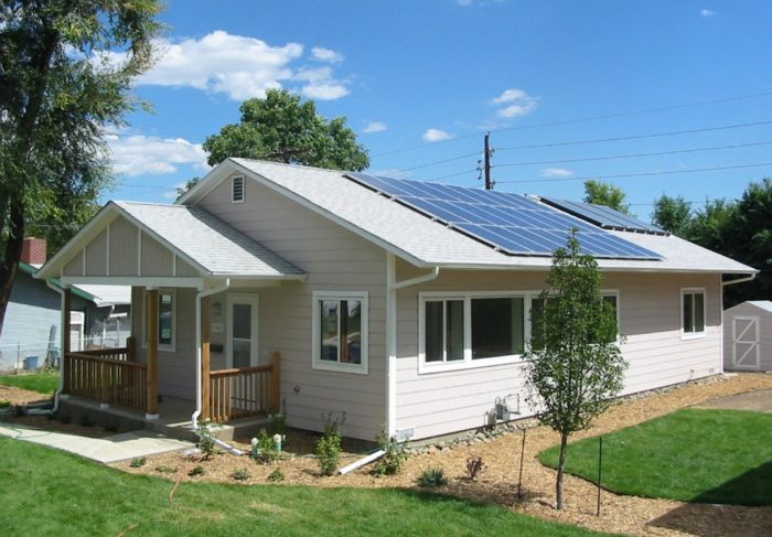

This net-zero energy Habitat for Humanity house in Wheat Ridge, Colo., was built in 2005 with help from researchers at the National Renewable Energy Laboratory. The 1,280-square-foot house uses a double-stud wall design insulated with fiberglass batts; its grid-tied photovoltaic system has a capacity of 4 kW.
Image Credit: Amy Glickson for NREL

Why would we want an individual building to be its own energy plant? This has never made sense to me. The scale seems inefficient and the potential of many existing urban buildings for net-zero energy (NZE) is limited. But many people I admire seem besotted by NZE. What am I missing?
