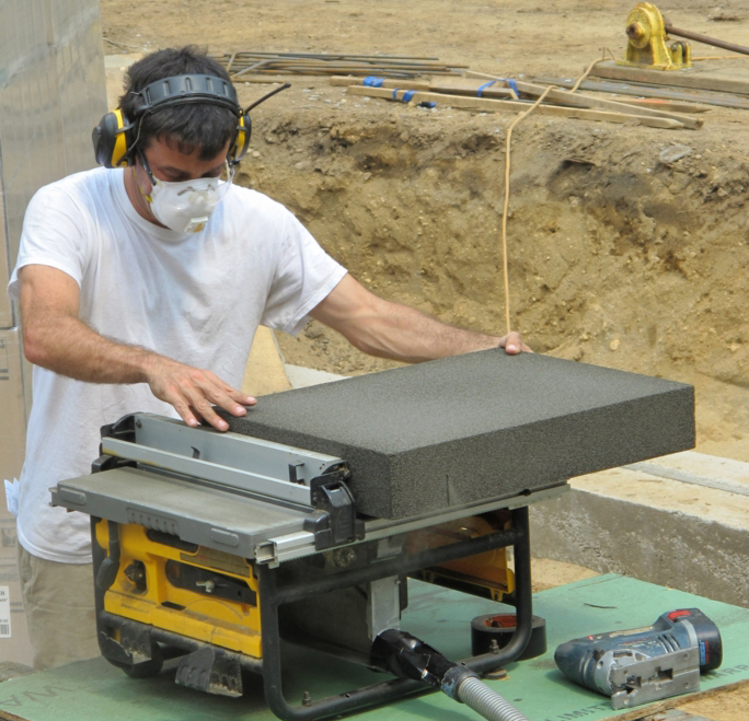

You can cut it with a table saw. Eli Gould cuts a piece of Foamglas for use under our basement slab.

We installed four inches of Foamglas under the basement floor slab and six inches on the exterior of the foundation walls. Our designer/builder, Eli Gould, and his six-person crew not only did admirably with this little-known material, but he came up with what I believe is a great option for adhering Foamglas to a foundation wall.
We were debating whether to use Pittsburgh Corning’s recommended solvent-based adhesive (“tar”) or their acrylic formula (a greener, water-based tar), which apparently doesn’t have quite as good performance properties as the solvent-based option. But the recommended solvent-based formulation sounded quite hazardous (it’s a two-component adhesive with one component consisting of three different types of diisocyanate and the other component consisting of petroleum asphalt, coal bitumen, naphthenic distillate, and hydrocarbon solvents). We wanted a well-performing adhesive, but the solvent-based option didn’t sound like something we wanted to expose workers to during installation or surround our home with.
Eli tested different engineered cement products, as modern polymers have dramatically changed the adhesive capabilities of cement in the last couple decades. They are also free of VOCs and sounded far safer from a health and environmental standpoint.
We settled on a polymer cement product  made by Ardex used for adhering stone veneer onto masonry walls, and it worked beautifully. The two companies (Ardex and Pittsburgh Corning) were so intrigued by our field-testing that they have begun conversations about testing and developing this alternative adhesive system.

    how is the foam glass to work w/? crumbly? pretty tough? when you saw it, are glass shards blowing about so you'd want to do that outside? looks like an interesting product.

    Relative to cutting Foamglas, we used a jobsite table saw with a standard, cheap masonry blade--and it cut like butter. Eli does have a simple vacuum dust collection system, which was helpful.
    The material is brittle and somewhat friable, but at a 4" thickness we didn't have much problem with breakage in walking on it. On a foundation wall, you can push it in and it dents where there are bumps in the concrete. Once they got used to it, Eli's crew liked it pretty well.
