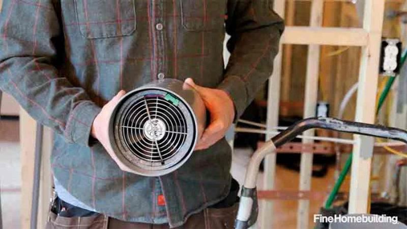

Simple and Effective Mechanical Ventilation
A look at how the Lunos E2 ventilation unit works and why it's a good fit for a small home
Josh Oduin is in Leavenworth, WA, talking about adding an HRV for balanced ventilation in his new cabin. He walks us through his reasoning for choosing the Lunos E2 HRV over a typical ducted system. The Lunos E2 is a collection of simple components. Most of the work is done by a constantly reversing pair of fans and heat exchangers that eliminate the need for the complicated heat-transfer components found inside typical HRVs. Josh gives a brief overview of how the units work and demonstrates the basic steps of installation.
Josh Oduin is a remodeler based in Portland, Oregon.

    Thanks for the informative video. I have been considering these Lunos HRV for some small studio apartments. Their relative simplicity and claimed efficiency is appealing. Some of my reservations are:
    Price; about $1200 for the kit with tax and shipping. In an expensive labor market, the total installed cost probably ends up over $2k.
    My understanding is that they are not a good substitute to bathroom or kitchen ventilation since the air flow is modest (10 to 20 CFM) and reverses every 55 to 70 seconds. So even for a small unit, I would be looking at 3 or 4 wall penetrations/unit.
    As someone pointed out to me, how long can one expect a motor that stop and reverses every 55 to 70 seconds last? – that’s roughly half a million cycle per year if running constantly!
    In a real world usage, I am a little dubious of the manufacturer’s claim of “Heat recovery efficiency: 90.6%”
    If anyone who has used these for a few years would like to comment -on the reliability aspect in particular- I am happy to be proven wrong 😊

      I'd be willing to wager a lot of money that the real world efficiency is well below 90%. They are almost certainly fudging with something like peak efficiency. Immediately after reversing flow, there is a certain amount of heat energy in the core. The longer the fan runs after that switch, the lower the temperature of the core, and the less heat you are recovering. The other trick they might be pulling is that instead of measuring total efficiency, they are just measuring the amount of heat captured by the core that is returned indoors, ignoring the fact that this energy return is on a 50% duty cycle. I suspect that the total efficiency of the system is in the ballpark of 45%.

          0degC outside, 20degC inside. In order for the device to be 90% efficient, the average air temperature has to be 18degC. If we imagine that we have the ports covered and the core starts at 20degC, as soon as air starts coming in, that core starts to drop in temperature. Let's say it drops to 16degC by the end of the incoming air cycle. This will give an average air temperature of 18degC, so 90% efficiency. So far so good. However, in order for this to be a sustained 90%, the core has to be able to recover 4degC in the same amount of time as it lost 4degC, except instead of an average 18degC delta, there is only an average 2degC delta. So it's not going to get anywhere close to the starting 20degC. Each cycle this imbalance in energy exchange is going to repeat, until the system reaches homeostasis. It seems kind of intuitive to me that the homeostasis point would be when the average core temperature reaches the midway point between inside and outside air, implying a theoretical maximum efficiency of 50%. Throw in losses and electrical power usage, and 45% seems about right. They could fudge this by time limiting the test, just for one example. And I could be completely wrong, all I know is that it seems fishy to me.
          1. charlie_sullivan | | #9
            The core isn't just at one temperature. There's a temperature profile from inside to out. And the fans reverse soon enough that it stays pretty close to its steady-state temperature profile.
            We agree that 3rd-party measurements would be best. Here's a third-party measurement of a different Lunos product, and they conclude that the manufacturer's data is accurate.

            I don't see that conclusion anywhere in there. Reading from the graph, what I see is that efficiency drops off a lot as flow increases; from about 88% at minimum fan power (7cfm) down to 64% at max fan power (53cfm). Note that doesn't account for energy used by the fan, so knock a few % off those for true efficiency. When you consider that the minimum flow rate on the E2 provides about enough fresh air for half a person or a medium sized cat, I think the efficiency at maximum flow rate is what we should be looking at (60%, if we assume it's similar to the model in the test). Even at maximum, the E2 isn't capable of ventilating even a bachelor pad apartment. You'd need 10 pairs of them to get the same flow as a medium sized conventional HRV.

      Traditional ac powered induction motors are stressed by starting or reversing. But the electronic controls on a modern dc-brushless motor (also called an ECM) mean that that process is smooth and stress free. The reliability concerns are more if line transients kill the electronics or if they electronics run hot 24/7 and die from time/temperature effects. A whole-house surge protector is a good way to make the former highly unlikely, and these are small and low power, so they aren't likely to run hot, and being from a reputable manufacturer, I expect they use high-quality components that will last a long time.
