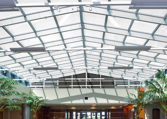

SageGlass can be tinted electronically to reduce solar gain and cut cooling loads. A new plant in Minnesota can produce sheets of the smart glass in sizes up to 5 ft. by 10 ft.
Image Credit: SageGlass
