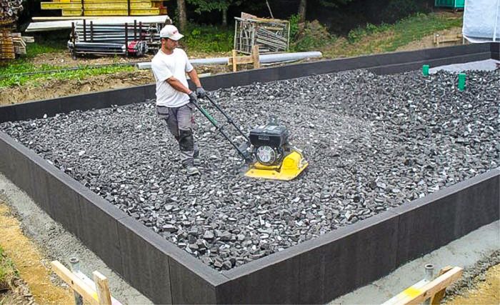

  3. [email protected] | | #5
    Please excuse my ignorance, but that first picture ... is that just poured stem walls that are then filled in with Glavel? And then presumably a slab is poured on top?
  4. GBA Editor
    Scott Gibson | | #6
    Dackdotcom,
    Good question. The walls are made of a foamed glass board called Glapor. (Here's a link: https://www.glavel.com/products_/glapor-boards/). The product can be ordered through Glavel and is produced in Germany.
    1. [email protected] | | #7
      Thanks Scott. This looks super cool. Are the boards attached to concrete? I did reach out to Tor at Glavel to see if there is a cross-section of this assembly. If I get anything I will post it here. The Glavel site is lacking any real good info.

      1. [email protected] | | #16
        Please explain what you mean about water penetration. Water would penetrate the Glavel ... where?
        As for "soil creep," in the Glapor video they put down a geotextile layer to prevent that.
