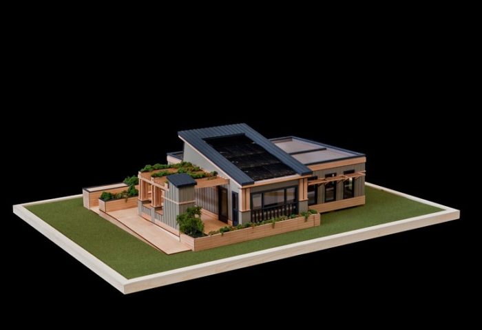

Team Tidewater Virginia is a collaborative Solar Decathlon team made up of students and faculty at Old Dominion University and Hampton University.

For its showcase at the Solar Decathlon competition, Unit 6 is designed as a free-standing single-family one-bedroom unit, but its function in the housing market will be as a component of a multifamily (six-unit) net-zero-energy complex slated for the Park Place neighborhood of Norfolk, Virginia. Unit 6’s exterior materials consist of exterior-grade plywood that functions as a rainscreen, battens, and trim. The main entry of the house opens into this sunspace, which features a large operable window that lowers to become flush with the railing that runs horizontally through the window assembly, converting the sunspace into an exterior space during the warmer months. A similar window system in the kitchen area also opens to the sunspace. Looking from the kitchen area into the living room. The north side of Unit 6. The utility core is enclosed in a pergola.
Team Tidewater Virginia set out to build a house that will work exceptionally well as a stand-alone home. The modular house is also designed to work as one of six units in a multifamily project being designed for the Park Place neighborhood of downtown Norfolk, Virginia. One key to bringing the project to life has been the team’s ability to see its multifamily project in Norfolk and its single-family Solar Decathlon entry as completely compatible, rather than divergent, enterprises. A collaboration of students and faculty at Old Dominion University and Hampton University, the team fittingly calls its Decathlon house Unit 6, and the team members seem almost as excited about eventually merging the house with the multifamily project as they are about showing off the building on the National Mall. Almost. At the Decathlon, though, Unit 6 will present as a 971-sq.-ft. one-bedroom home whose performance and amenities are being finely tuned to Washington’s fall climate and the expectations of the experts and regular folks touring the building. Its 2.64-kW photovoltaic array, for example, is designed to provide net-zero-energy performance on an annual basis in Norfolk, although it will accommodate seasonal conditions during the competition with an additional, 1.38-kW parallel array that will be installed on a flat-roof section of the building.
