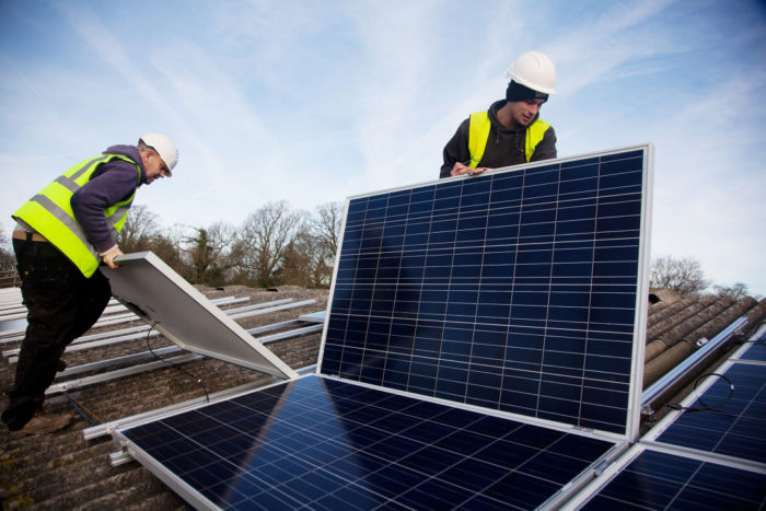

A homeowner wonders whether investing in a modest photovoltaic array is a good use of his money
Declining costs make small-scale PV systems attractive. Homeowners still have to weigh long-term costs carefully before taking the leap.
Image Credit: 10 10/ Creative Commons license/ Flickr
