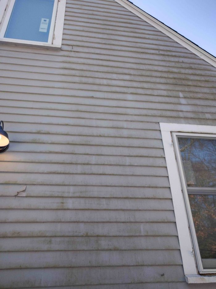

Dark side of the house: The north side of the author's house is showing its age, and the peeling paint and mold don't help. Among the questions he faces: Should a new layer of rigid foam be applied over the sheathing when the house is resided? Or should he skip the foam and invest the money in photovoltaic panels instead?
Image Credit: Apollo S
Apollo S has been making steady energy upgrades to his pre-war Cape Cod style house in Massachusetts. He’s replaced a steam heating system with a heat pump, and with help from the state’s energy efficiency program, he air-sealed and insulated his attic with cellulose.
As a result, his $250-a-month energy bills are one-quarter what they used to be, and Apollo now has his eye on the next round of upgrades.
“In a couple of weeks, I am getting a MassSave contractor … to dense-pack all empty walls with cellulose, so we are looking at, what — R-1 walls turning into R-12 or so?” he asks in in a Q&A post at Green Building Advisor. “Two-thirds of the walls are empty in a 3,000-square-foot house, so this should make a dent in my bills. Most windows are new, too.”
The four or five layers of paint on what is probably the original cedar bevel siding are peeling badly, and Apollo assumes that he will have to re-side the house sooner rather than later.
So here’s how his question shapes up: Will he be better off by adding 3 or 4 inches of rigid polyiso insulation over the sheathing when he re-sides, or using the same $20,000 to buy a 7-kilowatt photovoltaic (PV) system for the house and skipping the foam?

    Suppose Apollo adds an inch or two (or more) of foam on the outside of the wall in the pic...... won't he be nudged into at least some roofing work as well? There isn't any overhang on the rake to play with. Also, Apollo... What is the original sheathing material? If its pine boards instead of 4x8 sheets, would that let you keep the claps, assuming they're in good condition and you invest the labor? Now that you've read up on lead and already have the right kind of vac, have you tried the

    Mark: You asked, won't Apollo be nudged into some roof work to add foam siding? The answer is, it sure looks like it. See my recent blog, Making and Old Tract House Sunnier and More Efficient, under Green Homes on this website. I extended two roofs and its a lot of work, but to me it was worth it. I didn't see any other way to do it, if I wanted 4 more inches of foam. I wouldn't say I was "nudged" into it but, rather, bludgeoned into it, since it is not a fun thing to do.

    1. Clapboard is pine. Had siding specialist look at it. It isn't slavagable, because over year, as the house was expanded, previous owners just took the cheapest route possible with siding.
    2. Sheathing is T&G pine with tar paper over it. Tar paper is so old, you touch it, it crumbles.
    3. Roof extension - I have no choice, it would have to be done, since moment gutters are removed, I have only 3-4 inch overhang.
    4. I am in MA. Our economy here has always been good. Even in downturns people are buying homes, renavating, etc. Trades here are extremely busy and it shows in their pricing and responsiveness. The getting has been good for a while and it will not change. Can't fault them, because if same is in my business, I am not going to lose sleep over being more profitable.
    How about doing insulation and smaller (maybe 5kW, instead of proposed 8kW) PV setup with higher efficiency panels. If I add electric car down the road or see demand is still high, I can just add on to the system later
