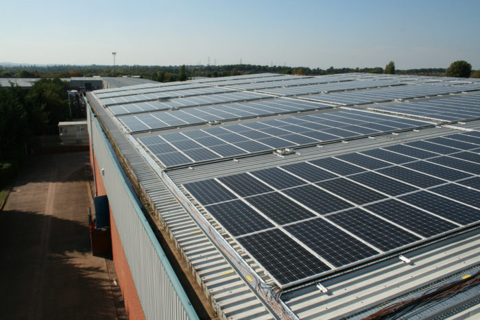

Electricity generated on the rooftops of buildings in the U.S. has the potential to hit 39% of current electricity sales, nearly double the amount that was estimated in 2008.
In a report, the National Renewable Energy Laboratory said that the “technical potential” of equipping all suitable rooftops was 1,118 gigawatts of capacity and 1,432 terawatt hours of electricity annually. That’s compared with 664 GW and 800 TWh in an analysis eight years ago.
The authors of the study said that previous estimates “lacked a rigorous foundation in geospatial data and statistical analysis.” This time, researchers said that they used light detection and ranging (LiDAR) data and other sophisticated tools to calculate the suitability for PV of rooftops in 128 cities around the country, collectively representing 23% of all U.S. buildings. The results were extrapolated to cover the entire continental U.S.
The PV potential was greater in some states than in others. California, for example, has the greatest potential to offset electricity, according to the report: 74% of all the electricity sold by state utilities in 2013. Percentages also were very high, 55% or more, in several New England states; they had a lower solar potential, but also lower per-capita consumption. Florida and Michigan also had better-than-average potential.
Even Washington State, with the lowest solar resource in the country, could generate 27% of its electricity with rooftop PV systems.
Researchers developed two statistical models, one for buildings under 5,000 square feet in size, and the other for medium and large buildings. Only about 26% of the small buildings were considered suitable for PV, but the huge number of buildings in this size class gave them the greatest technical potential — 739 GW of capacity and 926 TWh of electricity annually.
