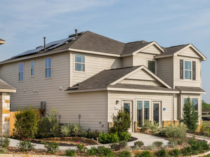

Developers have announced plans for two subdivisions in Austin, Texas, with houses that either come with solar panels as a standard feature, or are constructed to zero-energy standards. This one is part of Lennar's Colorado Crossing development.

    Austin's climate averages about 3000 CCD and 1600 HDD, so the GSHP will have signficant load to deal with if the building isn't sufficiently low-gain. The picture doesn't look like they skimped much on the west facing glass, and there's not much overhang to shade the south facing glass. Let's hope they simulated it adequately.
